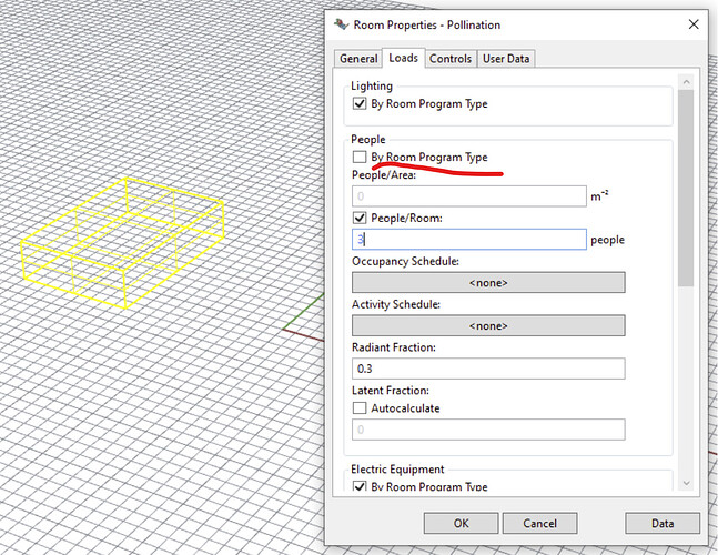

I beleive it is possible. Have you tried to change this under the loads tab?
The value here should overwrite the default value in the program type.

Hi @brentwatanabe,
We also have a component for setting up the absolute values for a room, which is the same as what we have in the Rhino plugin:
Once “By Room Program Type” is unchecked, the following people setting will override the people load from the room program.

Right, people/room is only available under room properties at the room level, and you cannot set it via propgram type.
I think it makes sense for custom residential program types, change the people load to 0 in the program type and set the absolute people count in room property.
