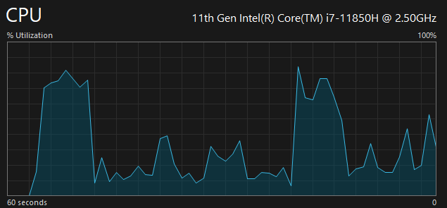

Why I am asking is that, when running one daylight study at a time using Pollination or Honeybee, you will often see inefficient use of the number of workers because there’s a lot of waiting happening to finish a task before being able to go to the next one. That is reflected in the CPU utilization graph:
For EnergyPlus, it’s possible to be more efficient using HB Run OSM. But even in the case of E+, there’s room for improvement if we’d be able to utilize the workers better. Because if you have e.g. 30 CPU cores in HB Run OSM, it’ll wait for each set of 30 simulations to be done before running the next set. I feel like Luigi/Queenbee could do that more efficiently without having to wait for a set of 30 to be done.
