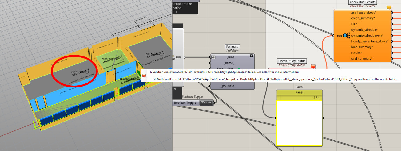

I’m running a daylight simulation in Rhino using the Pollination recipe for LEED daylight analysis (this is the only part of my workflow that uses Pollination). I’ve already validated the Honeybee model, and everything seems to be set up correctly. However, I keep getting this error for getting the results.
Could anyone help me? Any help would be greatly appreciated!

Hi @dydhuy,
Thank you for sharing the model. There was an issue in the post-processing, which I have fixed. You can update your core libraries to the latest version with LB Versioner.

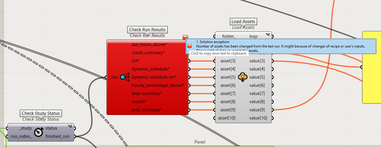

Hi @mikkel , thank you for the reply. There are no errors in the CheckStudyStatus component after updating to the latest version, but a new error has appeared in the CheckRunResults component.
1. Solution exception:
Number of assets has been changed from the last run. It might because of changes of recipe or user’s inputs.
Please right click to re-match the assets.
Could you please help me? I restarted Rhino it was still there. Thanks in advance.
It was solved after reconnecting these two components. Thank you!
