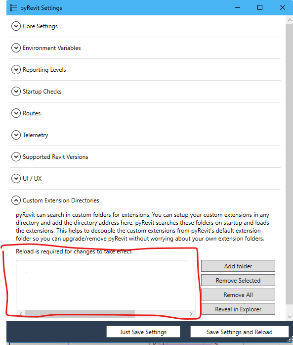

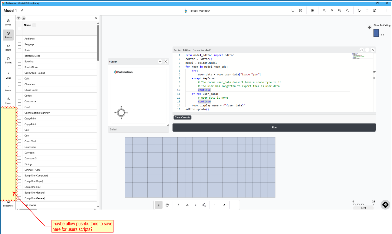

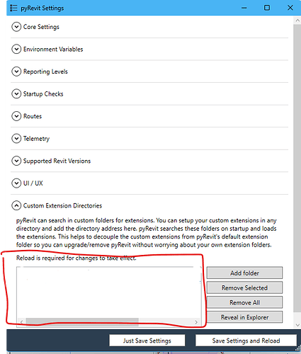

I still believe it would be better approach to have more flexibility with the Display Name rather than us having to write scripts, especially for those of us that don’t dwell in coding.
However, if the approach is to use the Script Editor, I think a way to auto-import scripts or to save them as pushbuttons could be a nice touch and load them from certain directories (like pyRevit).
Right now we only have the option to save and export the scripts to a .py file. The hassle here would be having to navigate to the location we save the scripts, open the script, and copy/paste into the Script Editor.
Just my opinion.
Hi @rafaelhok,
Thank you for the feedback. I like the ideas for improving the Script Editor and making it easier to use. We’re currently doing a full refactor of the Model Editor UI and how it works with Revit, and I believe we should be able to address both of your wishes once we are done with the refactor.
However, adding the functionality to load the scripts from a certain folder is something that we can add to the script editor without waiting for the full refactor. That should ease the process to access the scripts that you use frequently. What do you think, @antonellodinunzio?
