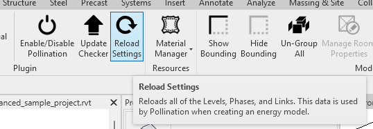

There is now a better way to do this in Revit v2.264.0 and later.
