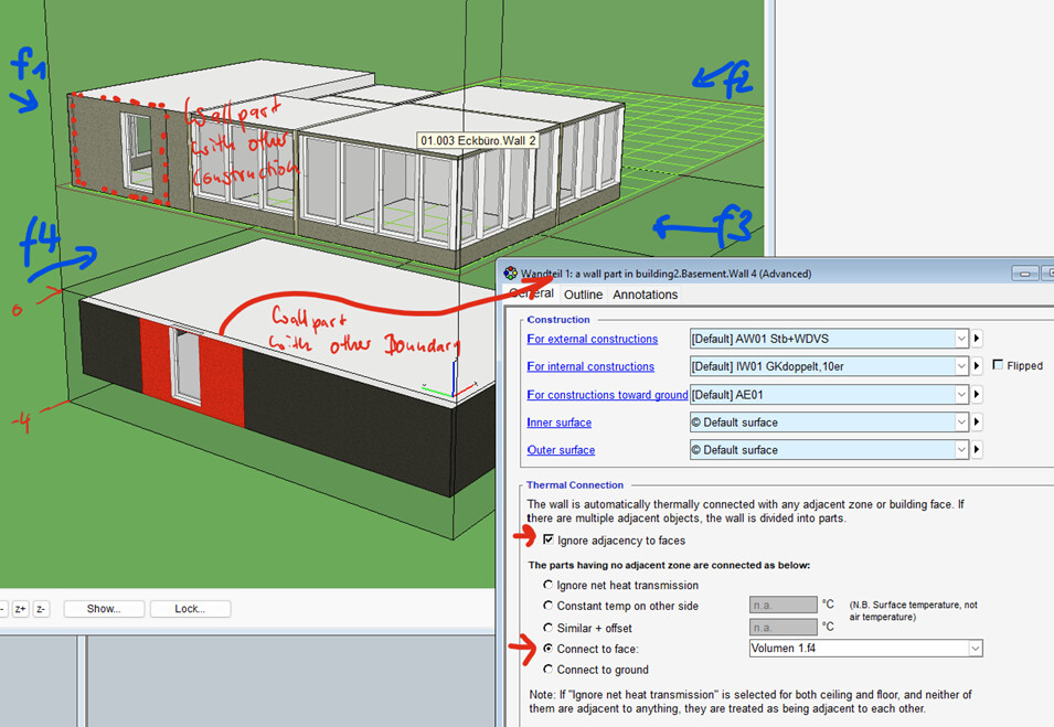

My goal is to add subsurfaces to distinguish between different constructions and to assign different boundary conditions e.g. for surfaces below ground level:

I made some changes in the code so that different constructions can be exported (only by names, without layers). I changed the export of windows and doors to take their type into account. Therefore for each window and door type a ressource is created and the element assigned to it.
This should make it easier to continue working with large models in IDA.
