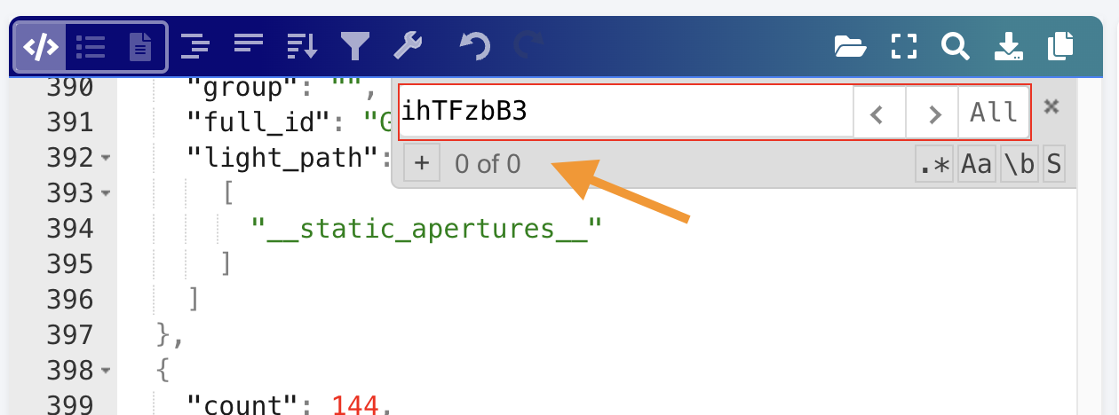

I tried to look for the custom id in the resulting grids_info.json file, but it’s not there, which seems to indicate the the cloud run did not use my ids:

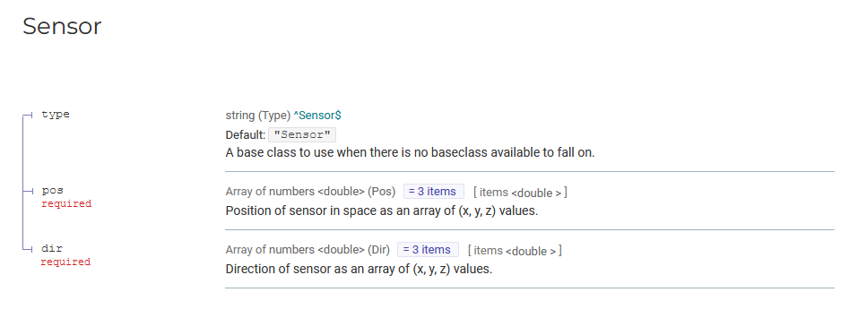

A sensor cannot have an identifier. You can find the specific sensor using its index in the sensor grid.
https://www.ladybug.tools/honeybee-schema/model.html#tag/sensor_model
