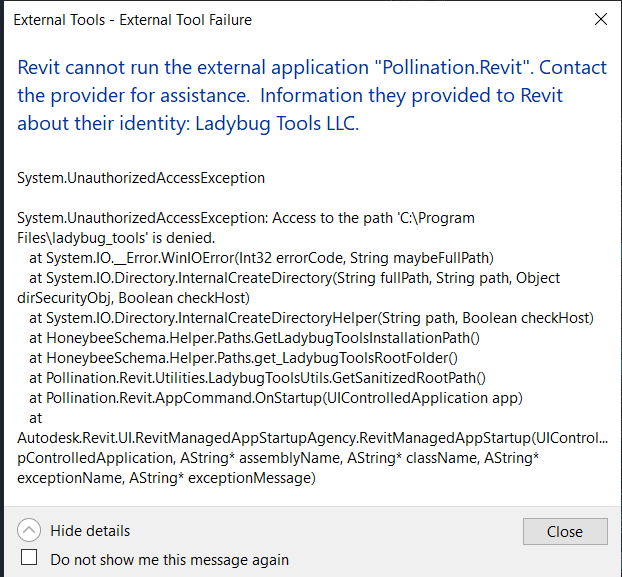

Revit cannot run the external application "Pollination.Revit". Contact the provider for assistance. Information they provided to revit about their identity
I get the following error when I launch revit after installing the plugin. This one looks different to the previous variants of similar errors posted on this forum.
Please suggest any fix, this plugin might solve all my problems once it works.
Thank you.
Hi @milindj,
Based on the error message the ladybug tools folder on your installation is either blocked or deleted. Can you check your antivirus and ensure they have been unblocked?
The folder should be installed under “c:\program files\ladybug_tools”
