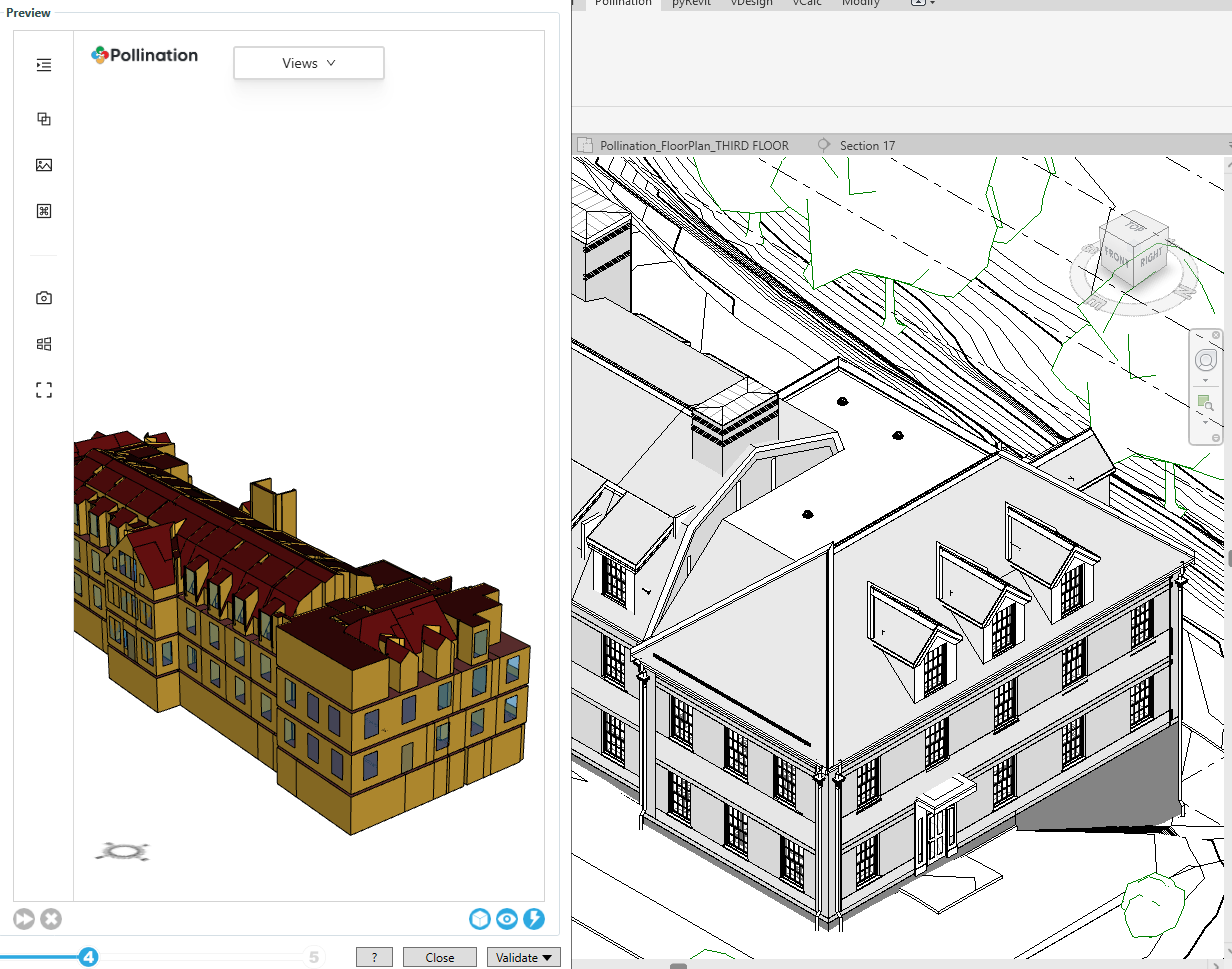

Hi, I am trying to bring this Revit model into pollination and it is showing incorrectly. The right image is the Revit model and left in the pollinator preview.
For all 3rd floor spaces ‘is top exposed?’ is selected.
In Revit, all roofs are ‘room bounded’.
If I use the full volume method for the 3rd floor, pollinator removes the dormers but includes the roof.
Does this look like an issue within the pollinator plug-in or is it something in the Revit model?

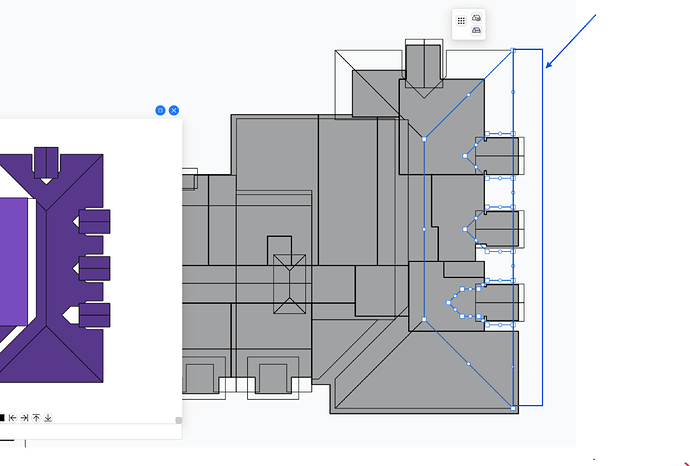

Hi @orobillard,
Thank you for sharing the model. Is it possible for you to share the Revit model with us? From what I can see, a segment of the roof is missing.
You can share the link to download the file with me in a private message.
If it is not possible to share the Revit model, then can you try to select all the roofs, create a preview, and download the roofs as an HBJSON? I wonder why the roof is exported the way that it has been exported.
Just for future reference here is how the model looks like after cleaning the roofs in the Model Editor.
