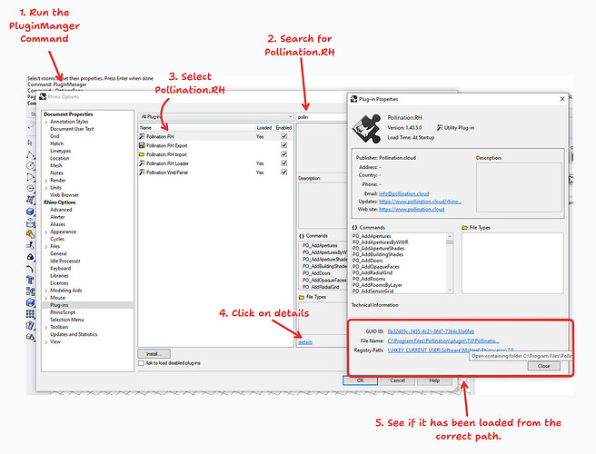

Hi @jroberts,
I meant the software registry. Here is the process to check the registry path from inside the Rhino plugin.

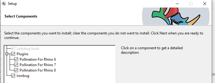

I suspect the plugin is loaded from some other path. If it is loaded from Rhino 6 folder instead of Rhino 7 then you should only install it for Rhino 7. The installer provides an option for that.
All fixed! As you suspected it was loading from somewhere else: I installed it in program files but I had my previous GH only Pollination stuff in C:\Users, probably led to some confusion. Reinstalled everything in C:\Users and working fine now.
