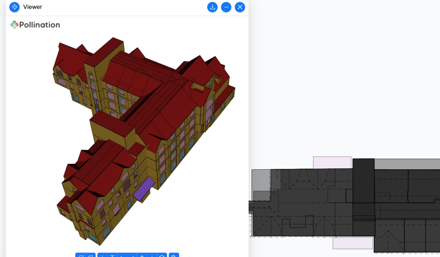

Hello, I have a building with dormers and slanted roofs, and I am having a hard time getting them to show up correctly. Portions of the third and fourth floor are showing flat roofs in spite of selecting Is Top Exposed and trying to align the roofs with the rooms. Below is a picture of the roofs:

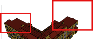

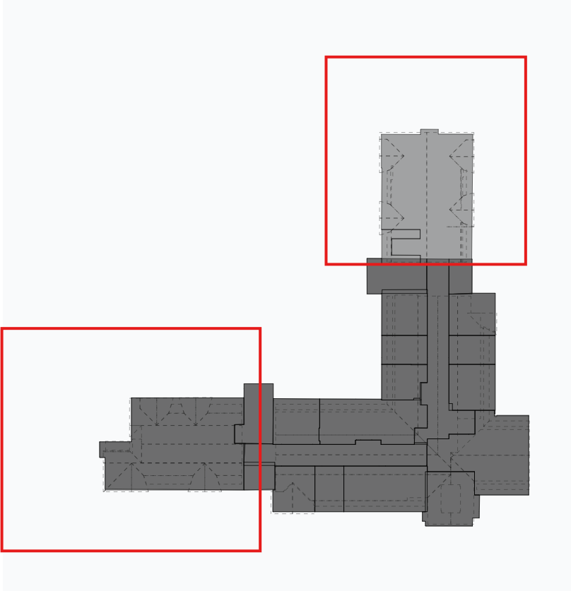

This is preview and the areas where i am having an issue:

Hi @priyakc, this is most likely because the roofs are not aligned correctly. If you can email me the PoMF, I can help you with the model.
Thank you Mostapha, i just sent you the pomf file through a discourse message, i also emailed it to you
Thank you for sharing the model. This was resolved after cleaning up the roof.
