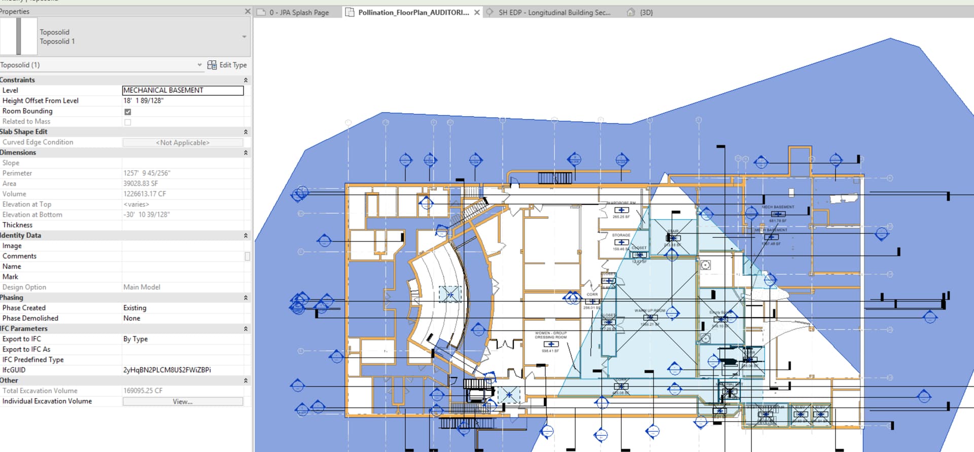

Hi @aj2cortina,
It has something to do with this Toposolid geometry. Set it not to be room-bounding, and everything should work as expected.
You still need to clean up the model, but at least the room boundaries are not going to change because of the inclusion of the topography.
Thanks @mostapha ! I went in and turned toposolid and all floors to not-room-bounding, and everything came in correctly!
