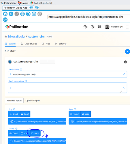

As you said, “PO_RunSimulation” command is not supported anymore. Therefore, you need to use the panel for running simulation.
You can always save your file in different formats including HBJSON through Rhino interface and then deploy as local model. However, you need to be careful that your model does not contain errors before running simulation.

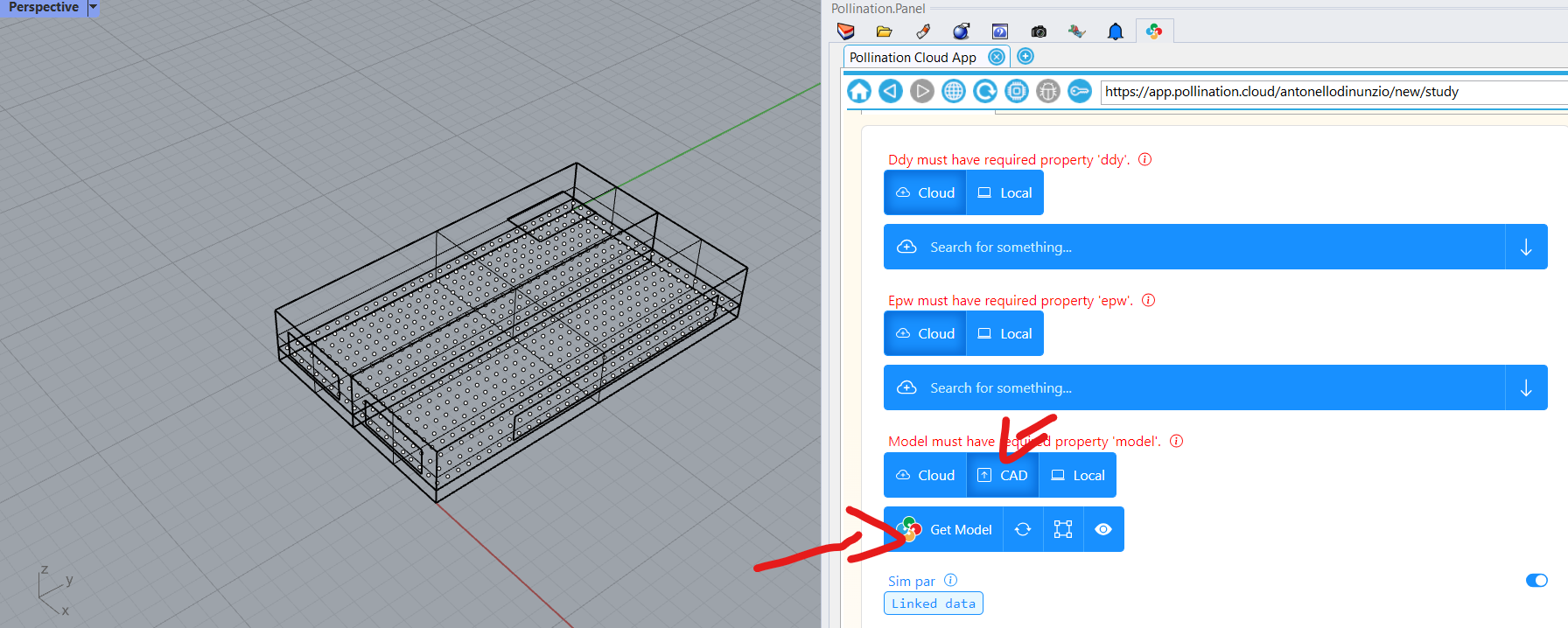

Hi @keigonomura, the other option is using Rhino directly:
  1. Set pollination rhino model with energy properties
  2. Link the model to recipe using GetModel button of the recipe form
  3. Add other missing required inputs

Hi @keigonomura.
From Rhino–> File–> Save as–> HBJSON. On the otherhand, @antonellodinunzio explained a better way with setting energy properties and use GetModel button.
Levent

As @antonellodinunzio mentioned, when you open the panel from inside Rhino, you can access the model directly using the Get Model option.

@antonellodinunzio @mostapha Thanks for the other option. I don’t know why, but the there was no “Get Model” button on the Pollination Panel (the image I attached above) yesterday, but now I can find the button.

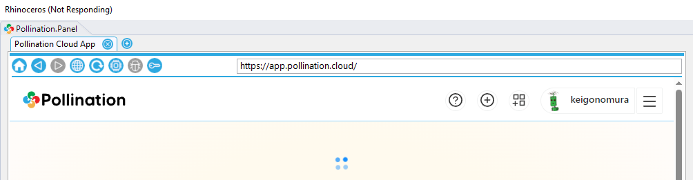

When there was something wrong with HBJSON file, @hlkocalioglu 's option showed an error message, but @antonellodinunzio 's “get Model” option did not show the error message and the Pollination Panel got stuck as shown below.
I think I shoud mannually convert to HBJSON file first and check if there is any error.
