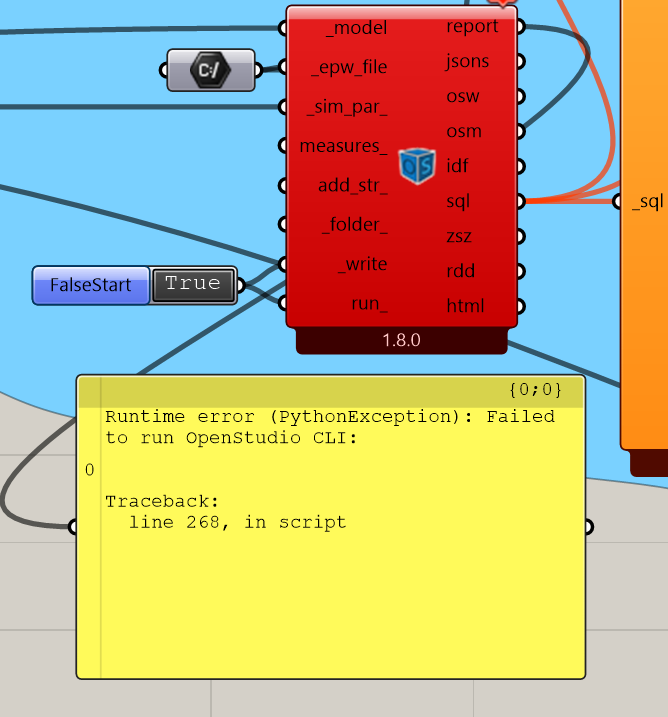

Runtime Error (PythonException): Failed to run OpenStudio CLI: line 268
Hey everyone - everything was working fine with this model prior to my trying to install the tool suite using pollination, in order to get Ironbug to work properly. Now, I’m constantly getting a runtime error referring to “line 268, in script”. I’ve tried completely uninstalling LB tools and OS, installing varying versions, in numerous combinations. I thought a clean pollination install would work but I keep getting the same error return. I’ve attached a screenshot but cant upload the model file. Tearing my hair out! Any help deeply appreciated.
Hi @bmpietras, try to replace the component with the one from the new installation. It should be version 1.9.
Hey thanks - that worked but revealed a host of new errors!
