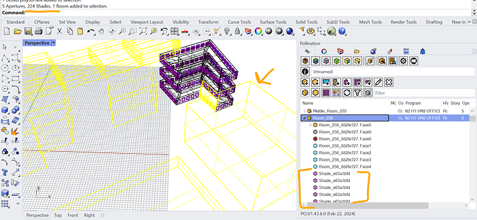

The simulations are running fine, but they are taking longer than usual because you have added the context shade to every single room in your model. See below.
That’s adding a substantial time to the shadow calculation step.

Unfortunately, I don’t have the Rhino plug-in at the moment, and am wondering what is the correct way to add context shading?
My model uses a multiplied mid-floor approach, so based on the context, some floors may get more sunlight than others (upper levels should get more sun than mid floors and the ground floor). I assume that this means that each level and therefore each room needs to account for the context shading. Is this correct?
Currently I am adding the context shading in the Grasshopper script between adding boundary shades to the windows and applying HVAC settings to the rooms. This step comes after all three levels of my model have been merged into one list of rooms.
Should I instead add the context shading directly to the larger HB model in the “shades_” input to the “HB Model” component, just before it gets inputted to the Pollination recipe component? Unsure if this would actually streamline the calculation process?
