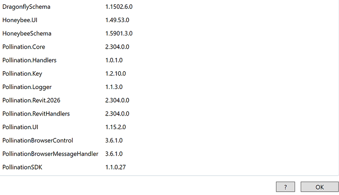

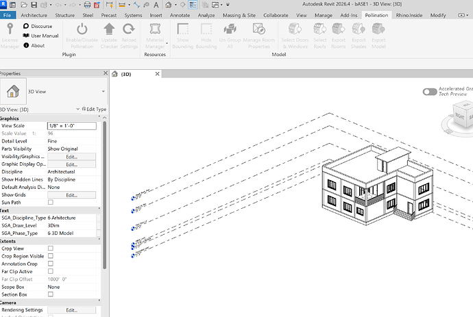

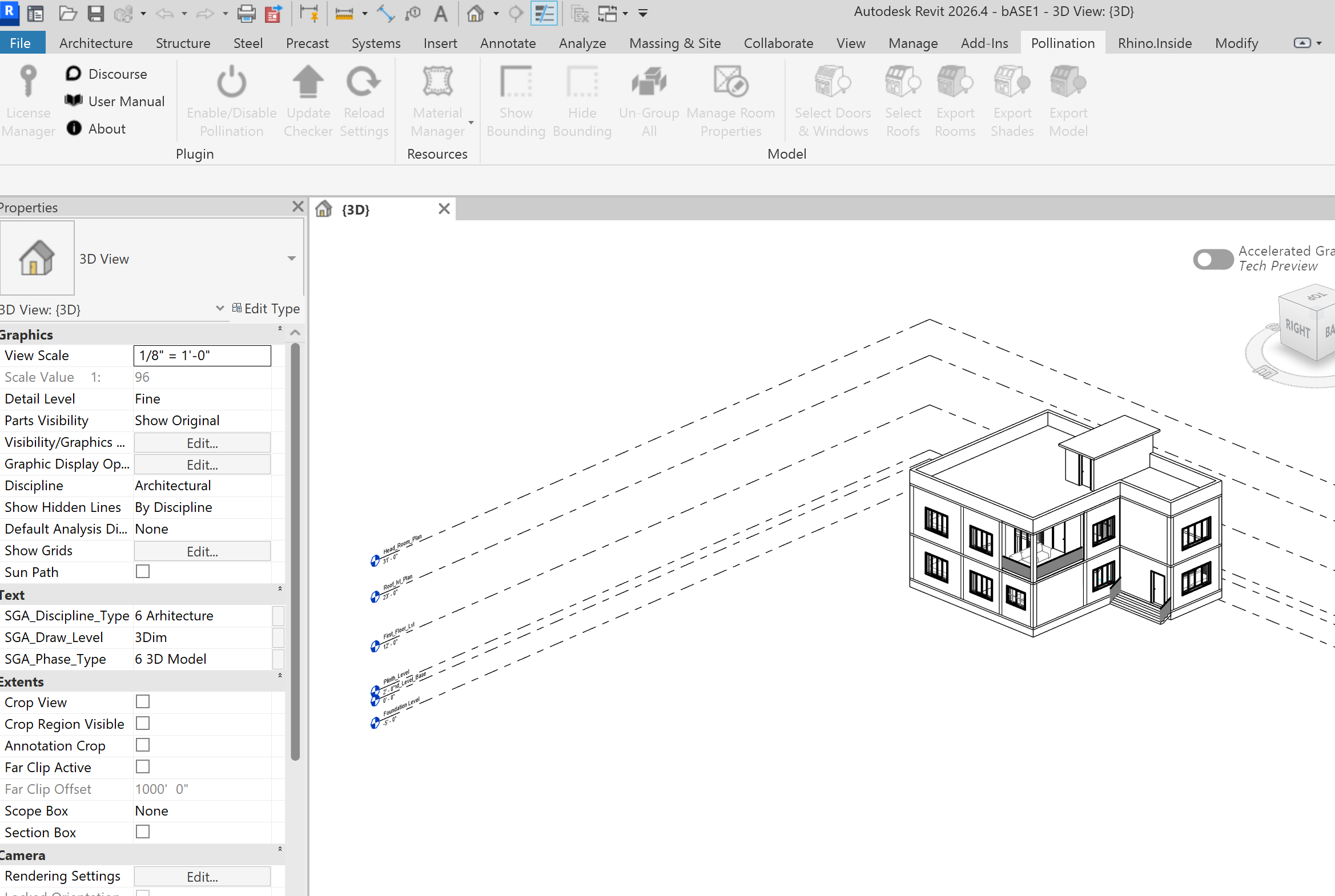

Hello all. I installed the updated version of Revit Pollination plugin and when I click on Pollination tab, its all greyed out.
Hi @asisnath,
This is most likely because of the DLL conflict. Can you disable Rhino.Inside and see if that resolves the issue. The license manager should never be grayed out.

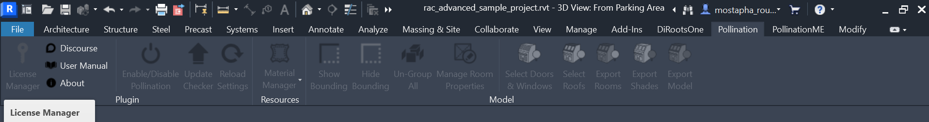

I was able to recreate the bug!
Thank you for letting us know. I reverted the installer to the older version until we fix this issue.
