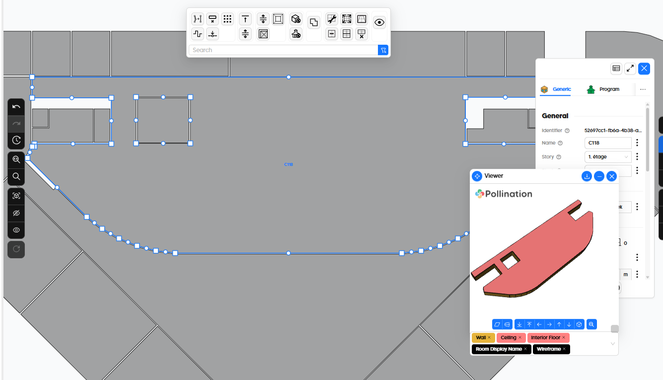

I’m not sure whether this is a bug or a setting, but I’m unable to import rooms with holes/openings into IDA ICE. They are displayed correctly in the Model Editor:
In IDA ICE
I created a room below it (the small one) as an example of how it should look when imported correctly.

Hi @davi, this looks like a bug to me. We should support these cases with no issues. I will check and report back.
