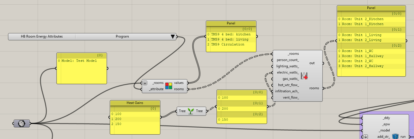

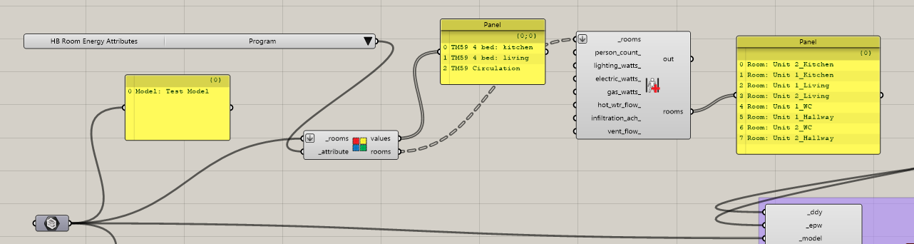

Thanks for this Chris. So what I want to do next is group the rooms by the programme type, then apply different fixed Watts for equipment, etc, depending on the programme type. I’m trying to use the HB Rooms by Attribute component for this, how do I get this to work? See below.
You are on the right track. Just don’t flatten the _rooms input into the apply “Apply Absolut Load Values” component and then you should also graft your corresponding list of loads that are coordinated with each of those programs.
Something like this?
Is there a smarter way I can coordinate the heat gain values to the program name? I.e., program “TM59 4 bed: kitchen” automatically gets 150W applied to it? Perhaps what I’d like to do is filter the rooms by each program name, then apply the heat gain, then bring them back together?

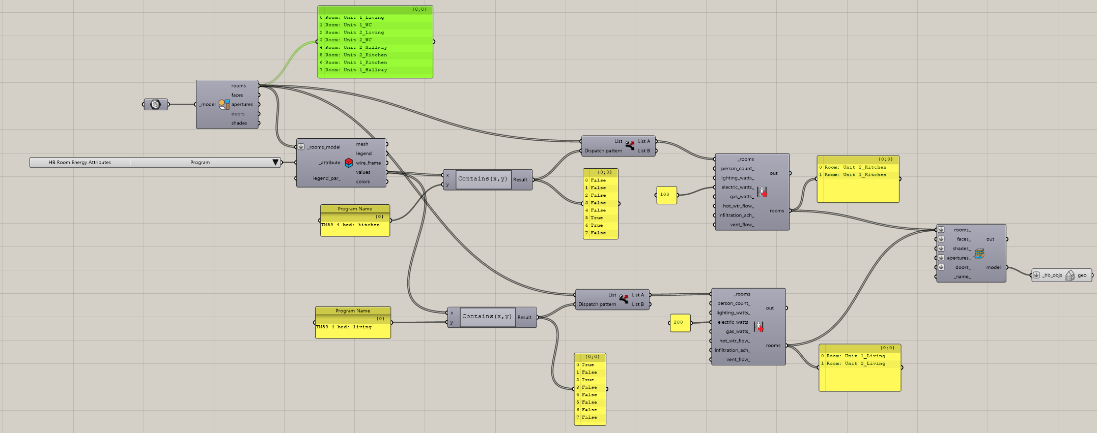

I’ve come up with the below, which is successfully filtering the rooms, allowing me to apply heat gains according to the Program name. Does it look right? Can I reassemble the HB model as I’ve shown? What happens if I have shading objects?
It looks good to me!

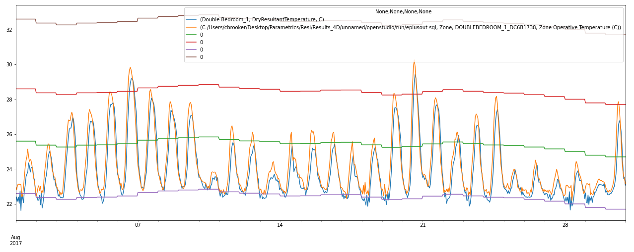

Hey @chriss,
Thought you might like to see this.
HB is orange,
IES is blue
Min comfort temp is purple
Neutral temp is green
Max comfort temp is red
Max adaptive temp is brown
I’m still getting my head around python, and need to do some digging into the differences between IES and HB (I’ve got some ideas in mind). But it’s nice to see proof of concept wise that the trends are pretty consistent between the two.
