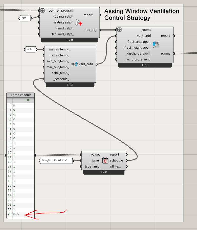

The way that I have gotten it all to work is by using a special schedule value for 11 PM, which you can see that I assign here in the Grasshopper script:
And I have changed the edits of the EMS program to recognize this special schedule value like so:
Basically, when the EMS senses this special schedule value, it will override everything else with the logic of open the windows fully when the temperature is >= 23 or close them fully if the temperature is < 23.
What follows from this is the typical controls that gradually open the windows more as the temperature increases. However, you’ll notice that these “gradual opening” controls only happen when the schedule values are >0, which you can see is only from 8AM-11PM in the schedule values.
Because there is no statement to set the opening values when the schedule value is zero, the windows should remain exactly as they were when they were last set in this condition. This should mean that the opening status remains constantly closed or open until 8AM given the value that last happened at 11PM.

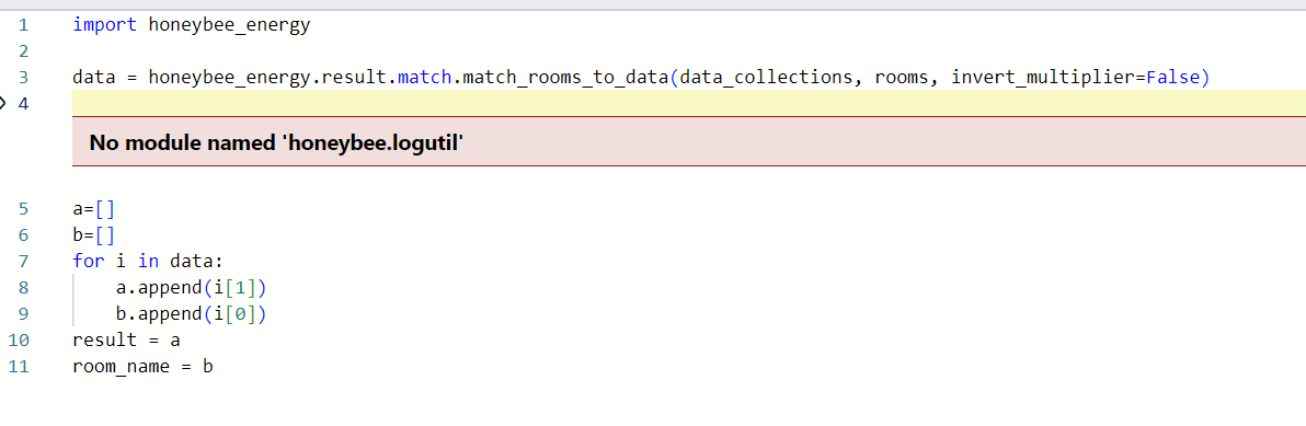

One final comment, after the upgrade from Rhino 7 to 8, some of my python components have the ‘old’ tag, I have been able to migrate most of these except this one which contains the following code:
import honeybee_energy
data = honeybee_energy.result.match.match_rooms_to_data(data_collections, rooms, invert_multiplier=False)
a=
b=
for i in data:
a.append(i[1])
b.append(i[0])
result = a
room_name = b
when I transfer over to python3 component I get the following error shown in the screenshot below. Any ideas as to why this is the case, and how I could fix this?

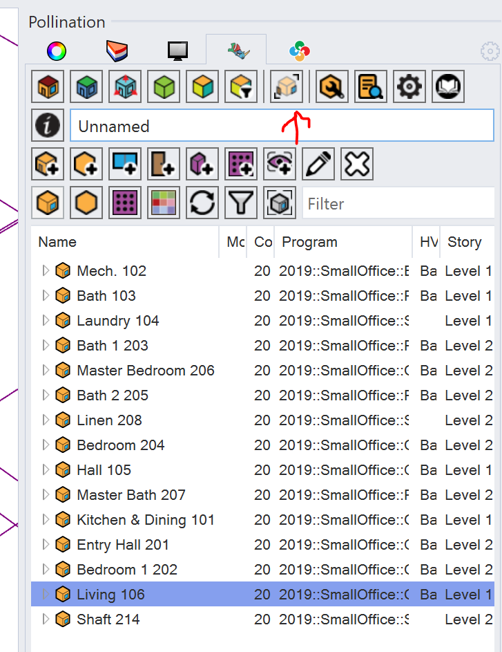

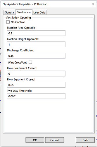

I personally find applying different operable fractions to different apertures to be MUCH easier in the Rhino plugin compared to Grasshopper. You just select all of the apertures in the Rhino document that you want to set a certain operable fraction on, then you use the PO_EditApertureProperties command to pull up an interface where you can specify the operable area of all the Apertures at once:
Note that, to have the most control over the Aperture selection you may want to turn the Room selection off first:
With this approach, you can easily specify different operable fractions for different windows of the same room, which is much harder to do in Grasshopper.
Yea, I would not worry too much about the OLD tag as your GHPython components are all still fully functional in Rhino 8. It’s just that McNeel added a new script editing interface, which they are trying to get everyone to use so they label the original one as OLD. If it bothers you, you can call this method inside the component to turn the OLD tag off:
As I said above, I would not worry about upgrading to the new Python components yet. You can either keep using the old component (optionally turning off the old tag) or, if you really want to use the new components, you should use IronPython instead of the cPython3 one (unless you have watched all of Ehsan’s tutorials and you set up your Ladybug Tools dependencies correctly). But we are not planning to upgrade our own Python components any time soon since it will be a long time until the whole community is using Rhino 8 and, even though McNeel labels the component as OLD, they have told us it will be a very long time before the deprecate them.

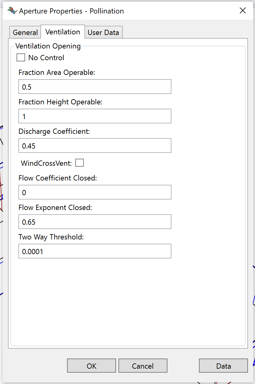

Thanks @chriswmackey that is super helpful! Is it possible to do this aperture opening application via rhino layers in some way? For example if I had different window geometries drawn on separate layers (grouped by aperture opening for example). This would be handy if the aperture opening areas changed for a particular window aperture group at a later design stage, or if you wanted to test different aperture opening areas for different window groups when simulating.
The only way I can imagine doing this is to then reselect all apertures you want to change manually in rhino, and then batch changing the opening areas using the command you describe above. Could you please clarify, apologies this is probably more due to my lack of understanding of the plug in rather than the limitations of pollination itself!
And yes I’ll post the MVHR question on a separate thread with more details on the type of system we are looking at :slight_smile:
Hey @milog ,
Yea, this is do-able by just right-clicking on the layer with the apertures and hitting “Select Objects”. Then you use the PO_EditProperties command to set the opening area like I said above. Granted, this won’t try to change the properties of any objects just because you move some new geometry onto this layer. But just reselecting the Apertures by layer and editing their properties should be pretty fast.

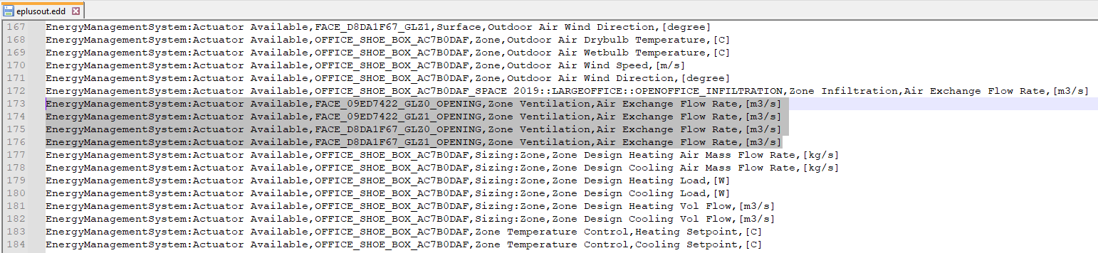

That approach with the Grasshopper components is not going to work as each component is overwriting the controls of the one that came before it. To create the “chain of controls” you’ll have to do some post-processing of the OSM (like I did for the AFN) or you can use additional IDF strings.
But just doing the chain of controls is not going to get you any special nighttime behavior. I looked at the EnergyPlus EDD and it looks like the EMS only allows you to control the total airflow rate (in m3/s) from outside to inside when you use the simple ventilation objects:
So it’s really simple and there’s no control of opening factors or anything like what you get with the AFN. Does the TM59 standard say anything about whether it’s ok to assume a constant flow rate through windows for the entire night time (regardless of wind speed or indoor/outdoor temperature difference)? If it’s not prescriptive there, then maybe there’s a way that you can still use the simple ventilation objects to check your compliance box.

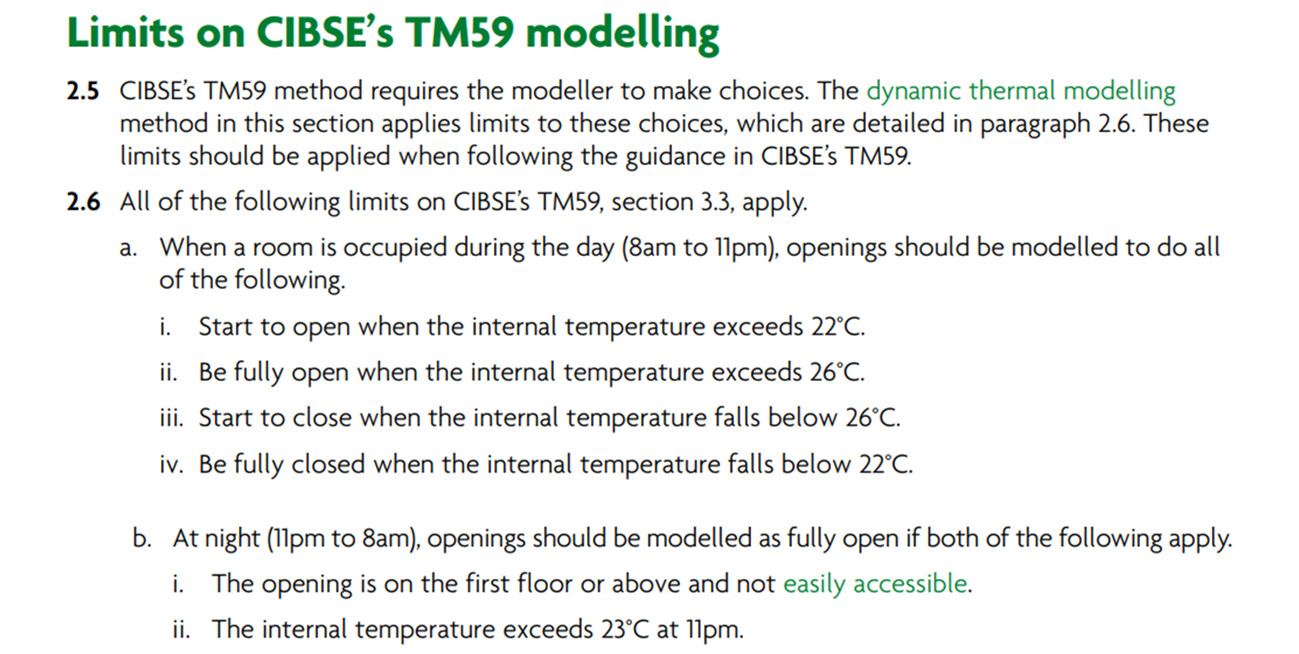

Hi Chris, the overarching methodology for compliance is dictated by Part O which states the following:
It sounds like meeting this to the letter is going to be difficult with the simple openings, but as a minimum I would feel a lot more comfortable with a system which uses a gradual opening for both the day and night time condition as this would put us in a reasonable degree of accuracy in terms of what Part O is asking for, and from what you have described this sounds possible using the simple openings.
