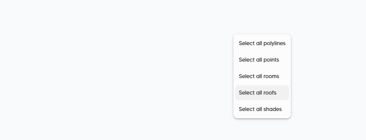

Hi! Which feature would you recommend me to delete the roofs to start over again?
The easiest way is to right click on the canvas to select roofs, and then press delete to delete them.
