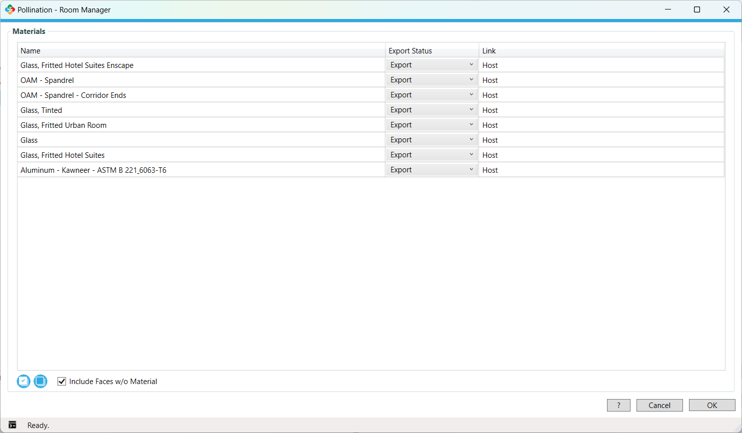

I’m wondering if there is a better way to export fenestration. Here is an example of curtainwall windows that I exported. The windows have gaps between them but we don’t want that.
I know that in the Windows module I can select the mullions to export, which I assume means that they will be treated as glass. This is what we want.
I would like to avoid the simplify windows command in the model editor because it simplifies too much.
What is the best way to get these windows but without having bands of wall between them?
