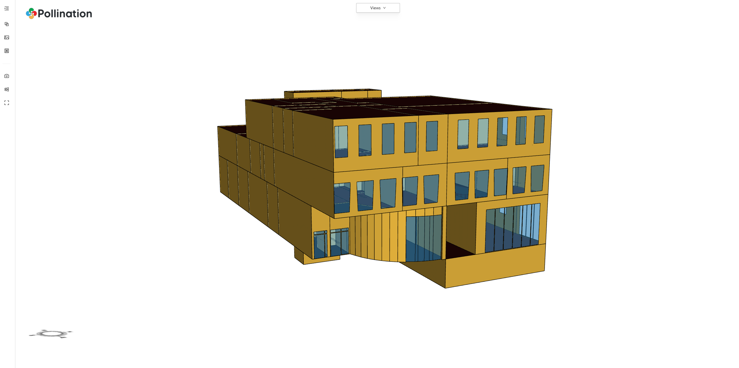

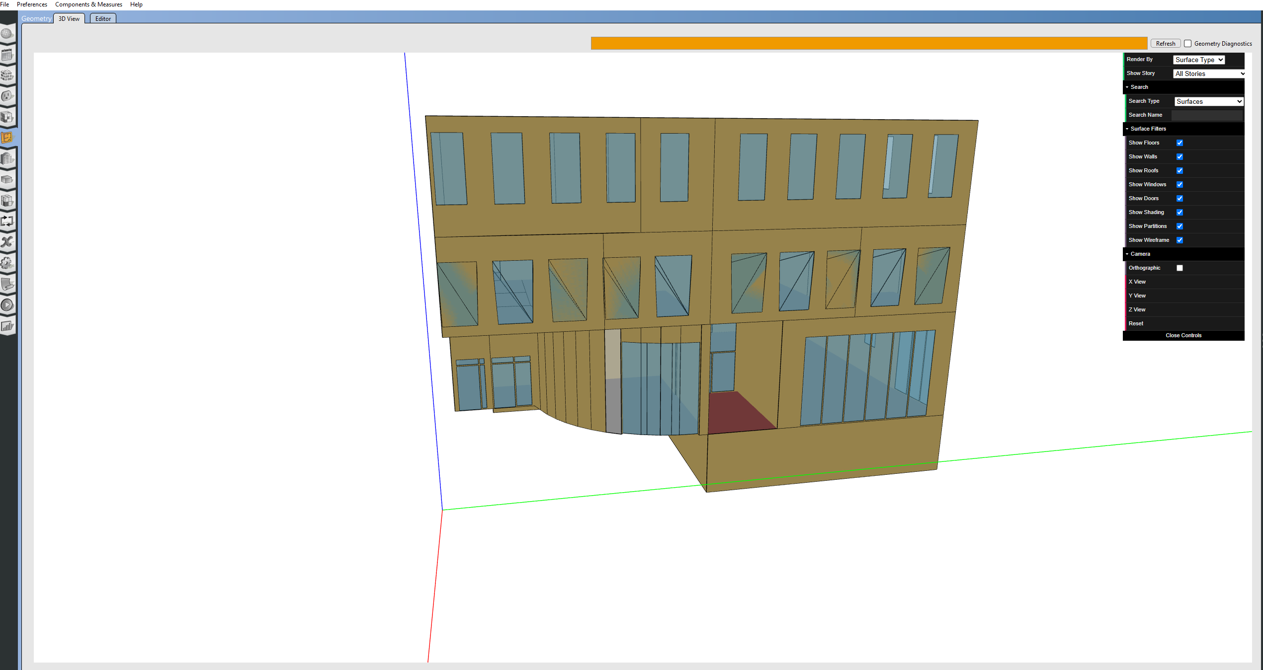

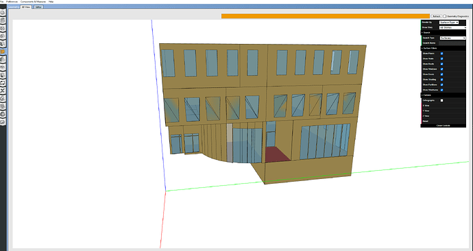

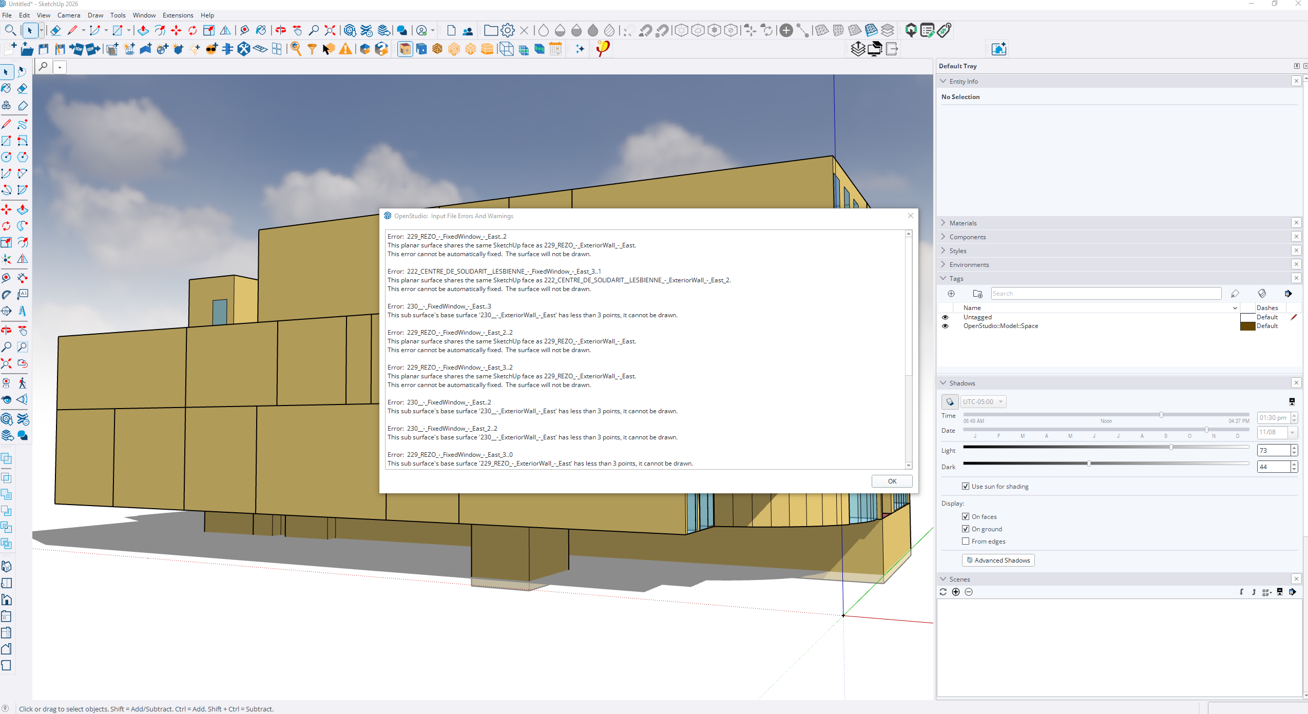

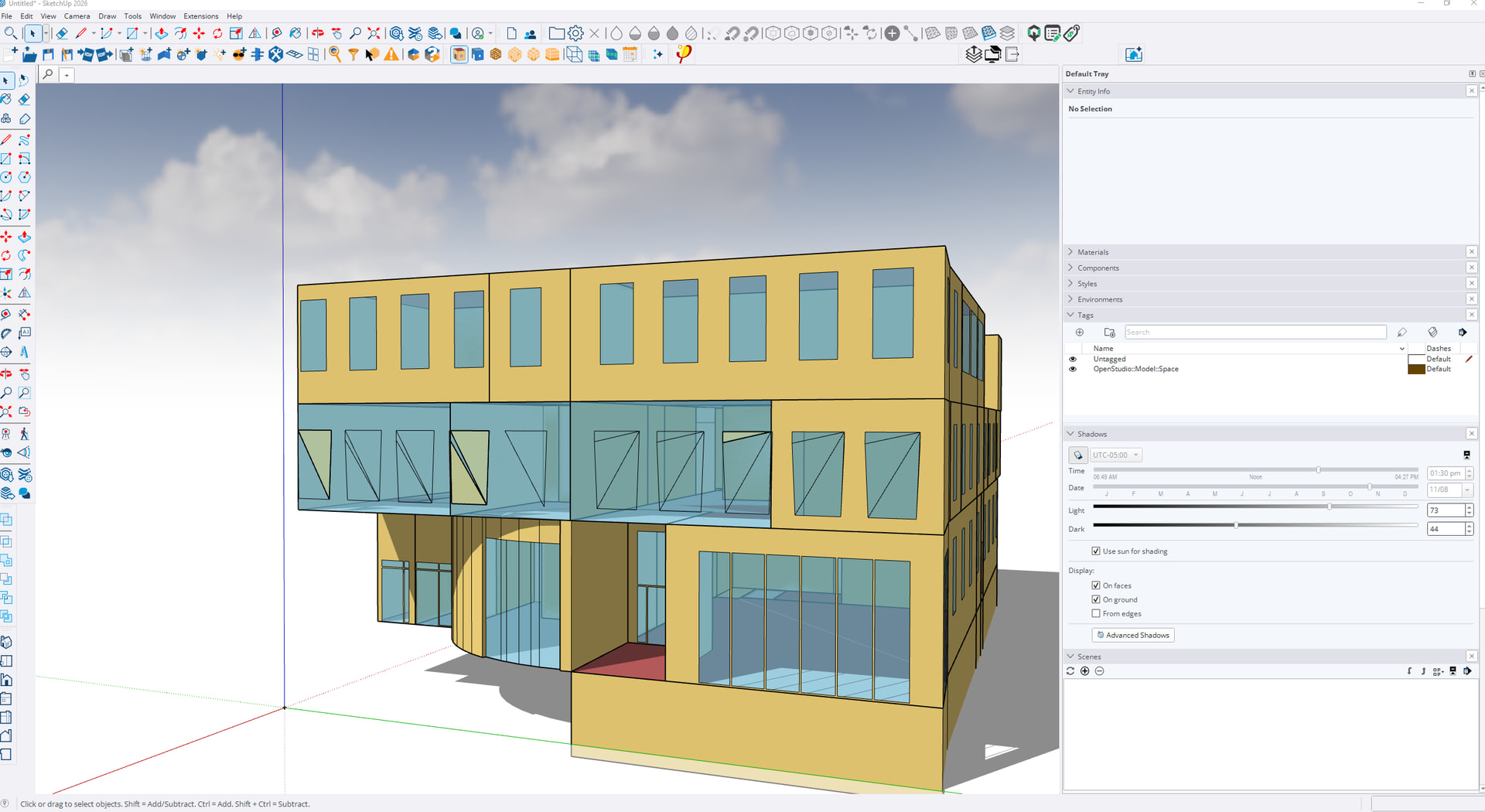

I’m working on a project and just finished modelling my project with pollination on revit. On the plugin it shows no problem and the windows and curved wall with glass, they look complete and with no problem. Also, when I run the check up and it’s good. When exported and opened on OpenStudio and also ont the OpenStudio plugin for SketchUp, the geometry of a facade is broken and the windows are not a whole rectangle and the curved wall, a surface goes missing. When I run the simulation, the is no fatal error. @mostapha

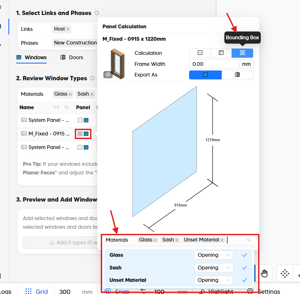

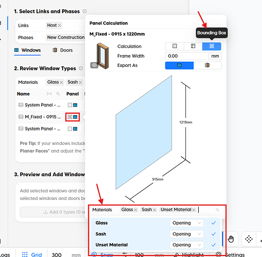

This is happening because those windows are non-rectangular. We triangulate them so they can be simulated in EnergyPlus.
To fix this, you can either simply set the panel calculation type to “Bounding Box” which will calculate the bounding box of each window as a rectangle or use the material filter to only keep the glass part of the windows.
Hi @mostapha ! Thank you for the warm welcome! :smile:
Oh I get it now! Thank you. It seems to work now.
