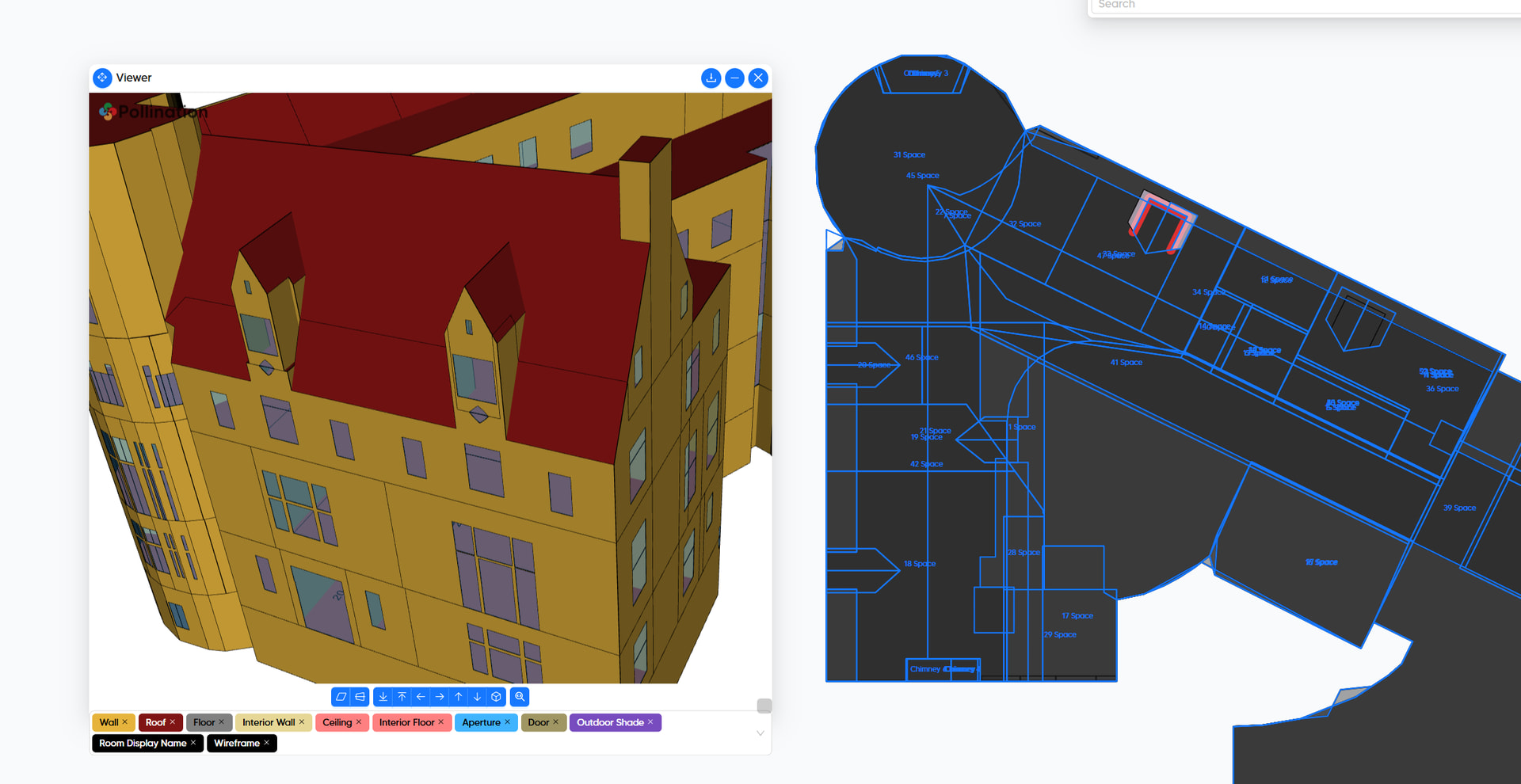

I’m a rookie user and am having two issues with my model:
The windows/doors I added to my Pollination model generally are not being mapped onto my exterior walls (perhaps because they were thick masonry walls and I may have offset the walls too far from the center datum).
My second issue is that part of the roof is not being applied to my rooms. Half of the top floor did take the roof surfaces correctly but the rotunda and other wing did not.

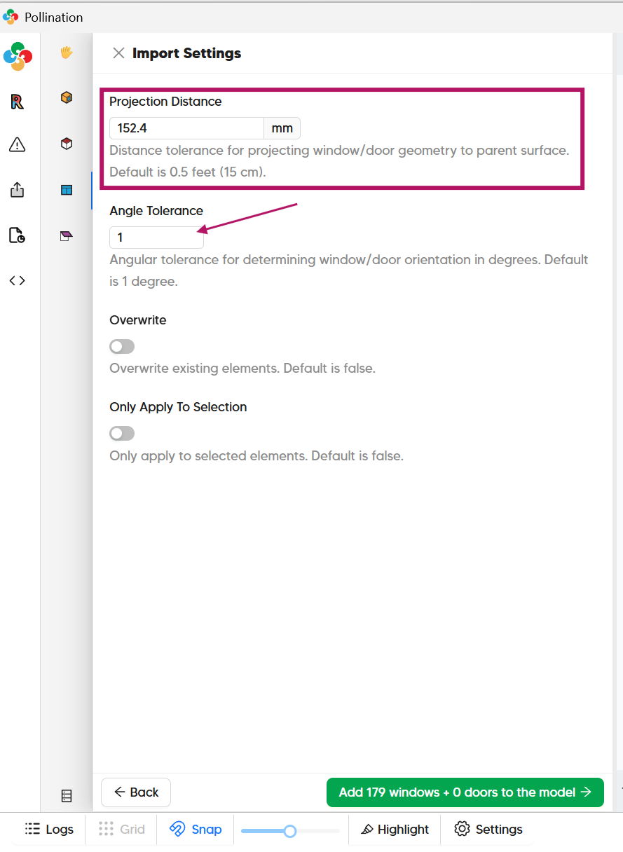

What values did you use for projection distance and angle tolerance? You may need to increase those values.

Thank you! It is actually my second model. First model went off without too many hitches (Revit-IES-CBECC). I tried bumping up the Projection Distance and Angle Tolerance for windows, still not working.

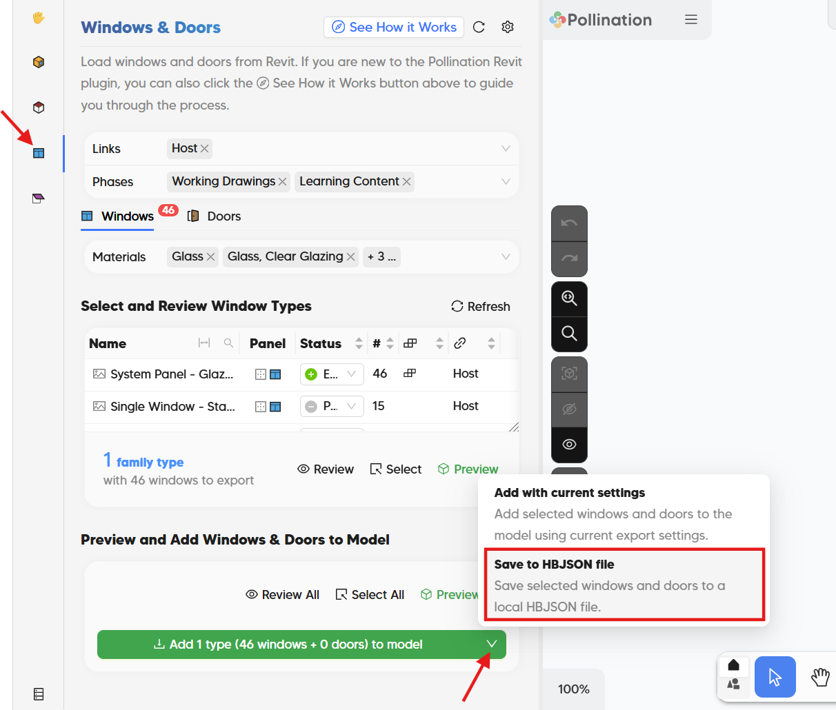

I also need you to download doors and windows as an HBJSON and share them with me to be able to test the process of projecting them onto the rooms. Here is how:

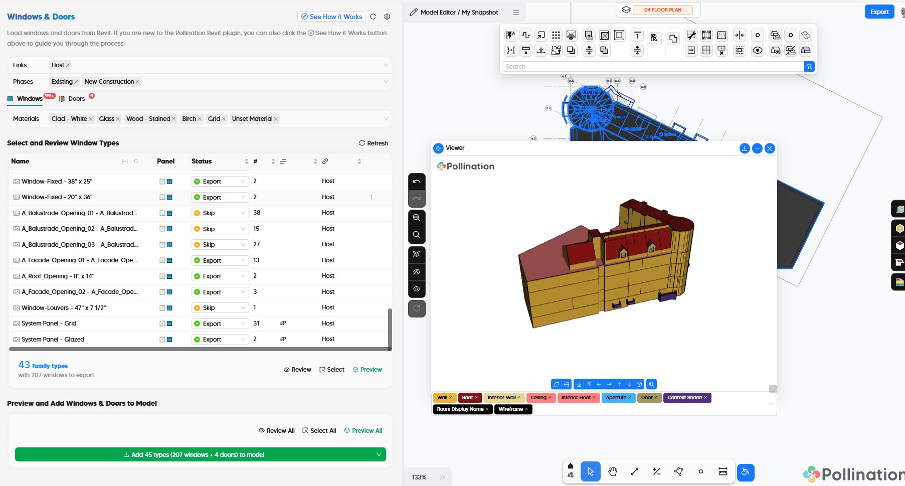

I’m adding a screenshot here for future reference.
