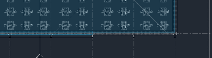

Hello - new to Pollination here, transferring Revit → IESVE. The export I made looks correct except for the fact that no windows or doors are appearing in the preview, and I am not sure why. I feel it might be an issue with the room creation, but I am not sure.
For example, this is the outer edge of the room. Could use some help!

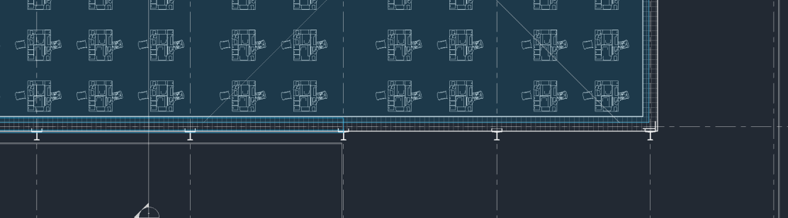

Hi @treyyarwood, did you make sure to change the export status for the windows and doors? See here:
Thank you for the response! That was the issue.
