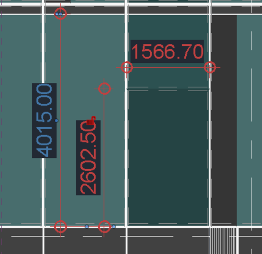

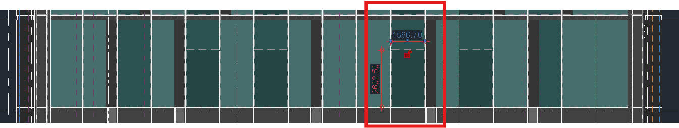

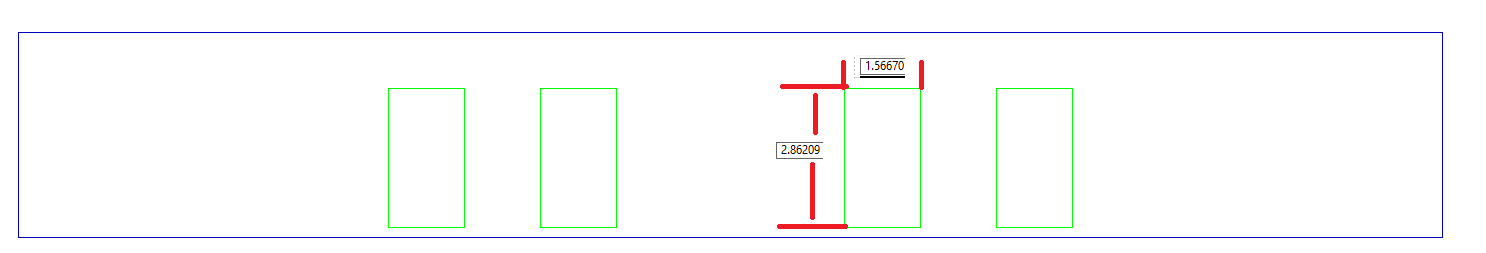

I am unsure what is happening with an export. In particular with window exporting but with the wrong height. Below an image of the Revit elevation and IESVE model with dimensions. Width is exact, but I am unsure where that height is coming from.

From the screenshot, it looks like you’re missing the top part panel in your windows selection when selecting them in Revit.
If you can share your Revit model, and the PoMF model with me, I can review the model, and record a video for you that shows the process.
Hey, I think the colors do not help, but the top part of that is opaque spandrel. The family for this glazing does include the two section, but then the window height should show 4,015mm if it doing that interpretation. I need to check if I can share that Revit model as it is from the Architect.
Hi @franciscocontreras,
Thank you for the sketch. The Revit model will definitely be helpful. I would check the panel to ensure it does end where your dimensions are. Ignore my first comment. I thought you’re asking why the window doesn’t go up all the way. Now I see that your questions is totally different.
