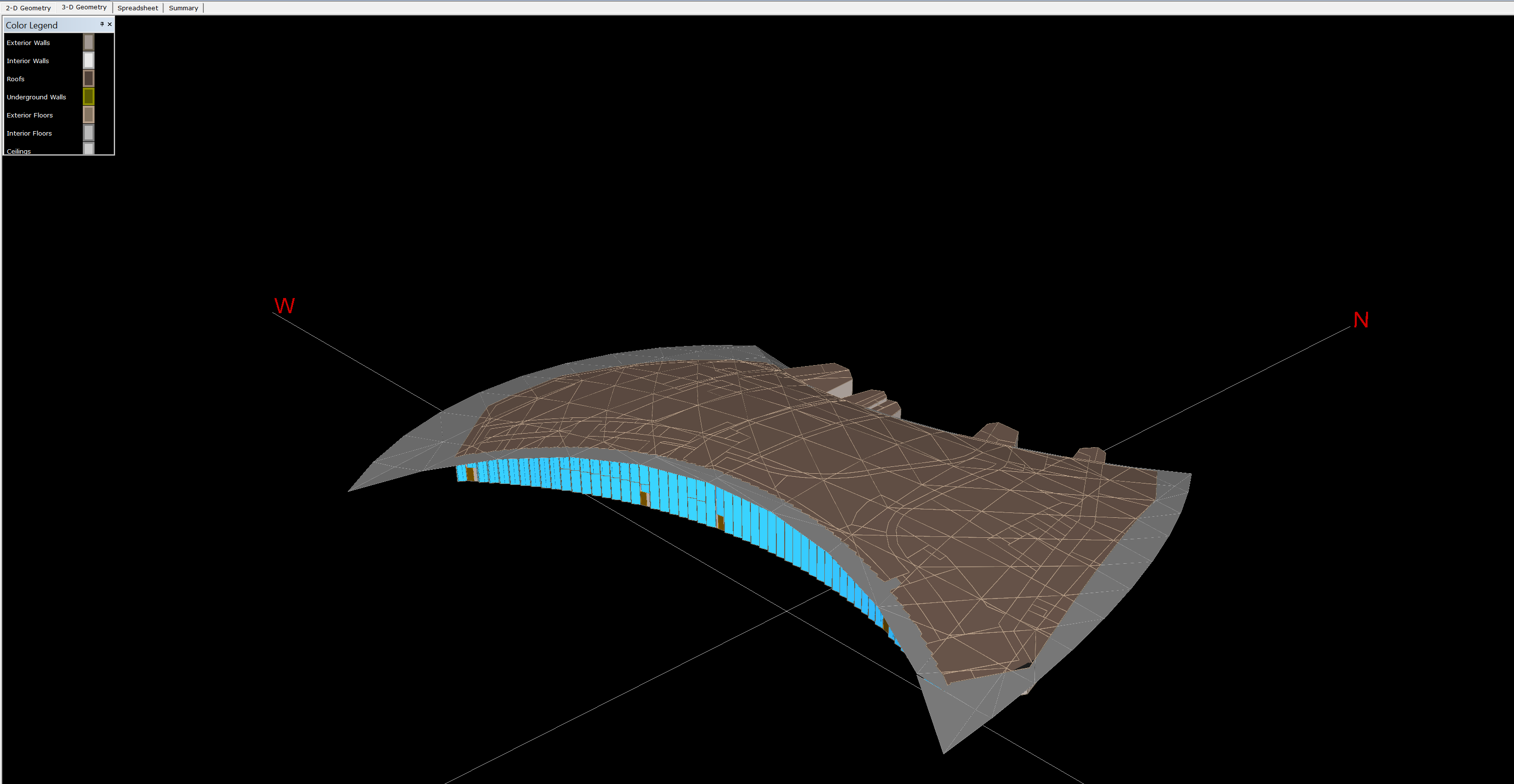

When in the roof export tool, I can see that roof is composed of a mesh of gazilions of little triangles.
I suspect that a direct exporting might not be a bright idea…

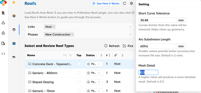

In the new version of Revit, which I should be able to release publicly by Monday, we have a new parameter for Mesh Detail that can help with ensuring you start with a simplified version of the roof by setting it to a low value. Preferably, 0. Here is a screenshot of the settings.

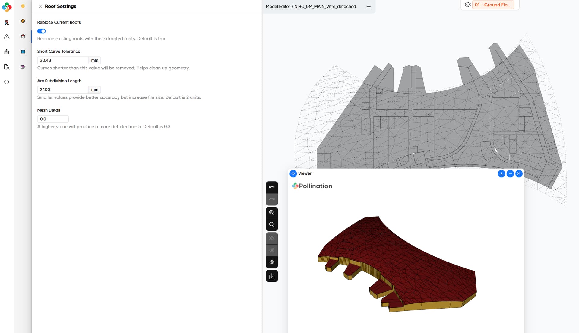

I ran a quick test with the large faces of the roof, and after setting the Mesh Detail to 0 I get this:
As you can see, the roof shows up but I’m not sure if this is a good model for energy simulation. I will record a video for you, and include a step to simplify the roof in Rhino. I know you don’t have access to Rhino but it is still something to be aware of.
At some point we will need to look into better automated ways in the Model Editor to simplify the curved roofs but for now using Rhino/Grasshopper is the easiest way to do it.

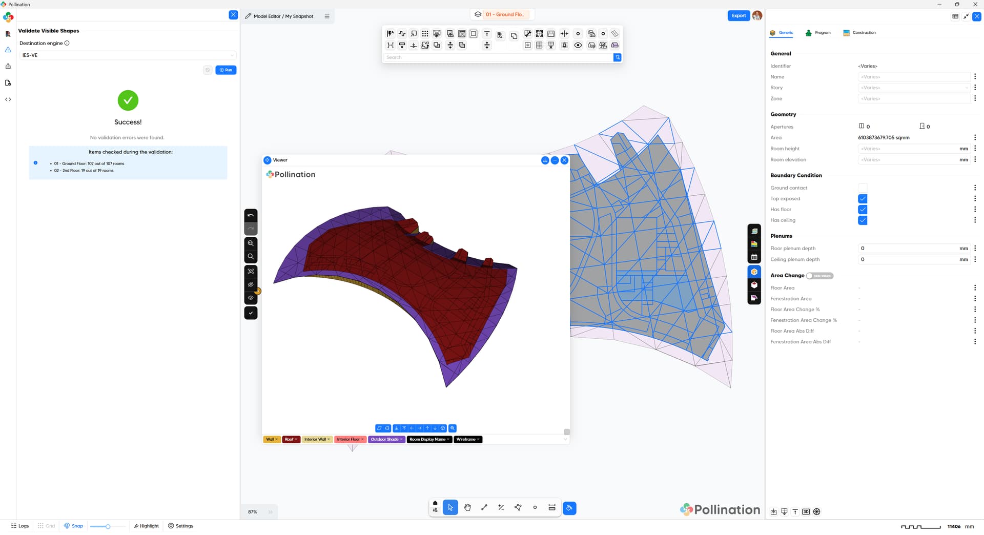

Here is cleaned up version with help from Rhino to simplify the roof for future reference.
