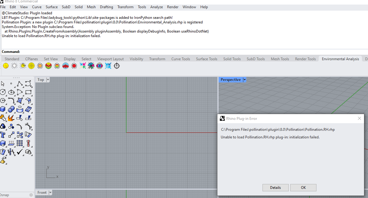

After installation Rhino plugin the following issue appears:
“Unable to load Pollination.RH.rhp plug-in: initialization failed”
Also, when try to check my license, it doesn’t allow to use any PO commands, showing them as unknown commands

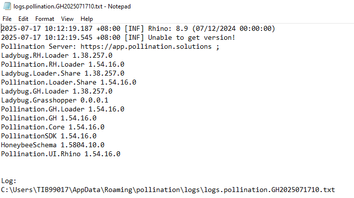

Hello @mostapha
Snapshot of the recent log file. Unsure if it explains anything.

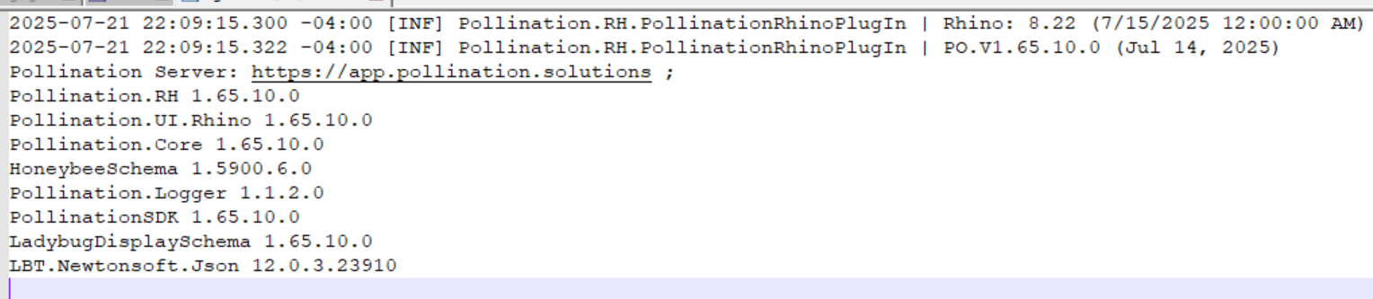

Hi @raunakt,
Thank you for sharing the logs. You’re several versions behind. Is it possible to update Rhino and the Pollination Rhino plugin? Here is what I see on my end.
Hi @mostapha
We tried installing the latest version of pollination i.e. 1.65.10 but its not working. And for some reason in the logs still show 1.54. Any recommendation to do a clean uninstallation.
That’s helpful. Yes. This is telling me that the wrong DLLs are being loaded from another installation.

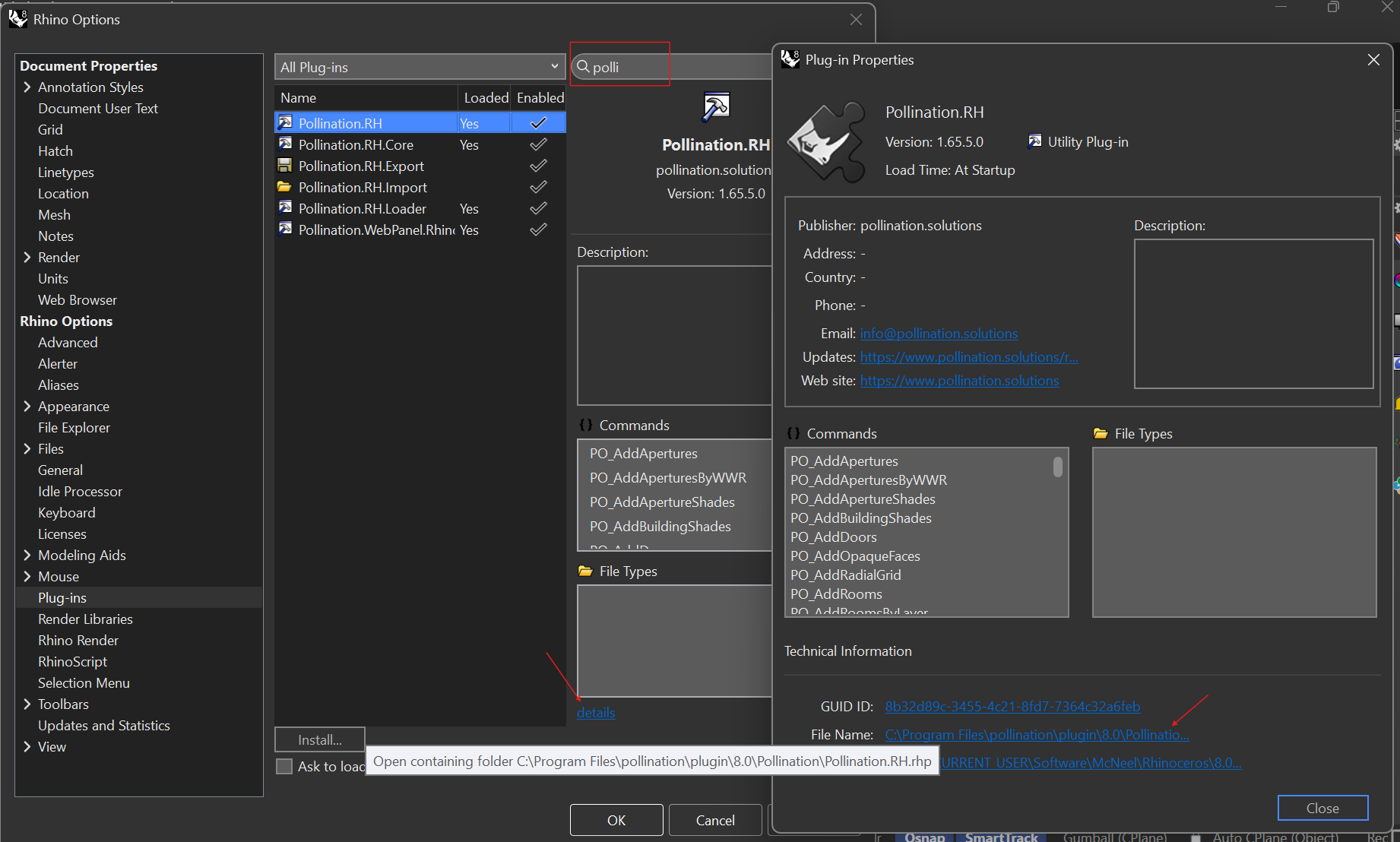

Can you try the PluginManager command and see where the DLL is loaded from. You might need to uninstall or delete an older version of the plugin manually.
  1. Run the PluginManager command.
  2. Search for Pollination.
  3. Select Pollination.RH and click on details.
  4. Check the File Name. It should be C:\Program Files\pollination\plugin\8.0\Pollination\Pollination.RH.rhp
Also, if you have multiple versions of Rhino, you might need to ensure to only install it for Rhino 8 to help Rhino 8 find the correct DLLs. See here:

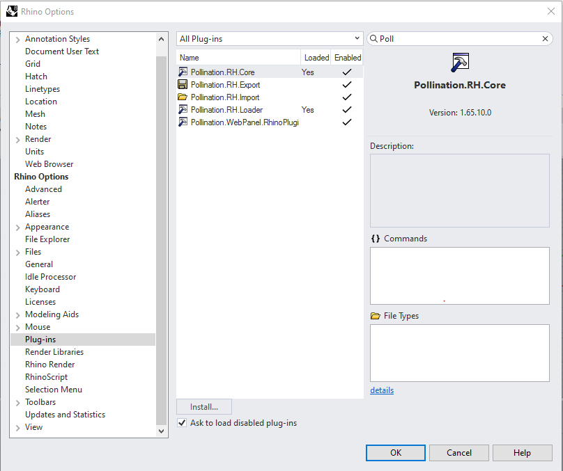

When I search for Pollination in Plugin Manager, I cannot find Pollination.RH but can see others.
I do have Rhino 7 and Rhino 8 on my system. I am getting the same error on both versions. Also, tried installing just for Rhino 8 and still same issue.
Can you check the file path for one of the other dlls? Say Pollination.RH.Core.
All other dlls are loaded from - C:\Program Files\pollination\plugin\8.0\Pollination
Pollination.RH.Loader loaded from - C:\ProgramData\McNeel\Rhinoceros\packages\8.0\Pollination\1.65.10\net48

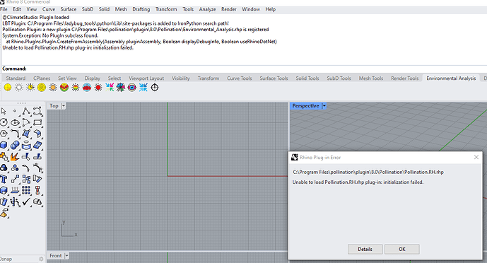

Hi @mingbo , Yes,
the file is there in the folder. But when I drag and drop to rhino, it gives same error message that unable to load-initialization failed.
Hi @raunakt, thanks for the update.
That’s really weird, and I can see the Environmental_Analysis.rhp is loaded without an issue.

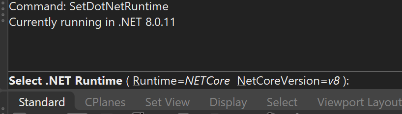

Before updating Rhino 8, can you try to use command SetDotNetRuntime to get what version of dotnet runtime you are using with Rhino 8?
Hi @mingbo, I uninstalled all previous versions of Rhino and performed a clean installation of Rhino 8. After that, I installed the Pollination plugin, which worked fine for a day. However, it has started throwing the same error again, and I’m unable to understand what might be causing the issue.
Rhino version - Version 8 SR17 (8.17.25066.7001, 2025-03-07)
Dotnet version - .NET Framework 4.8.9310.0
Hi @raunakt did you manually set NET Framework 4.8.9310.0 for Rhino 8 on purpose? Rhino uses .Net 8 by default.
