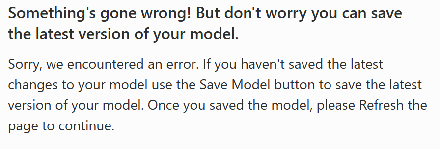

I’m using a trial to test your impressive piece of software, which I’m pretty convinced of its importance in the workflow between revit and IESVE. I’d like to see it in action, but I’m facing some error during launching. Here is the debug info:
TypeError: Cannot create proxy with a non-object as target or handler
    at Fa.e.get3DContext (https://editor.pollination.solutions/6807.js:2:243038)
    at Fa.e.initialize (https://editor.pollination.solutions/6807.js:2:241441)
    at Fa.e.buildPass (https://editor.pollination.solutions/6807.js:2:241309)
    at e.apply (https://editor.pollination.solutions/6807.js:2:105467)
    at e.traverse (https://editor.pollination.solutions/6807.js:2:105326)
    at e.traverse (https://editor.pollination.solutions/6807.js:2:197995)
    at Fa.e.traverseAllPasses (https://editor.pollination.solutions/6807.js:2:257896)
    at l (https://editor.pollination.solutions/6807.js:2:264408)
    at e.render (https://editor.pollination.solutions/6807.js:2:275051)
    at e.updateViewport (https://editor.pollination.solutions/6807.js:2:1276432)
and I’m seeing this:
I don’t think this is revit-related because I get the same error if I click on Model Editor in the desktop app. This is the info from the log file:
2025.11.13 11:52:01.447|info|⌛ init
2025.11.13 12:03:34.678|info|⌛ init
Looking forward to read your insight.
Regards

Tried that already with the refresh page button, doesn’t work, always appears the same error. Any other ideas of what I can do to fix it?

that worked! So it seems to be an issue with the Model Editor V3. Is there anything I can do to help you debug the issue?
