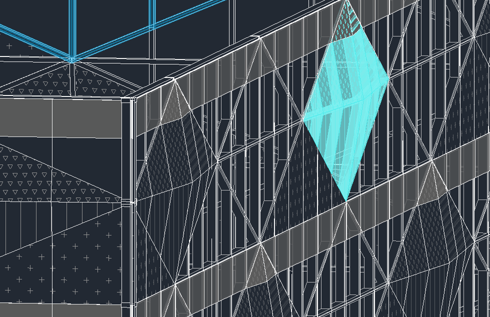

Hi all, I have this curtain wall system that is not vertical, it has panels at other angles and they are not coming through in Model Editor even though the count and family type shows up.

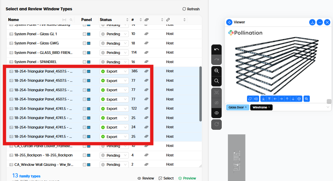

What do you see when you click on Panel column? Do they show up correctly there? That should help you debug the case.

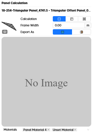

This is what I see, I’ll see if I can share the model:

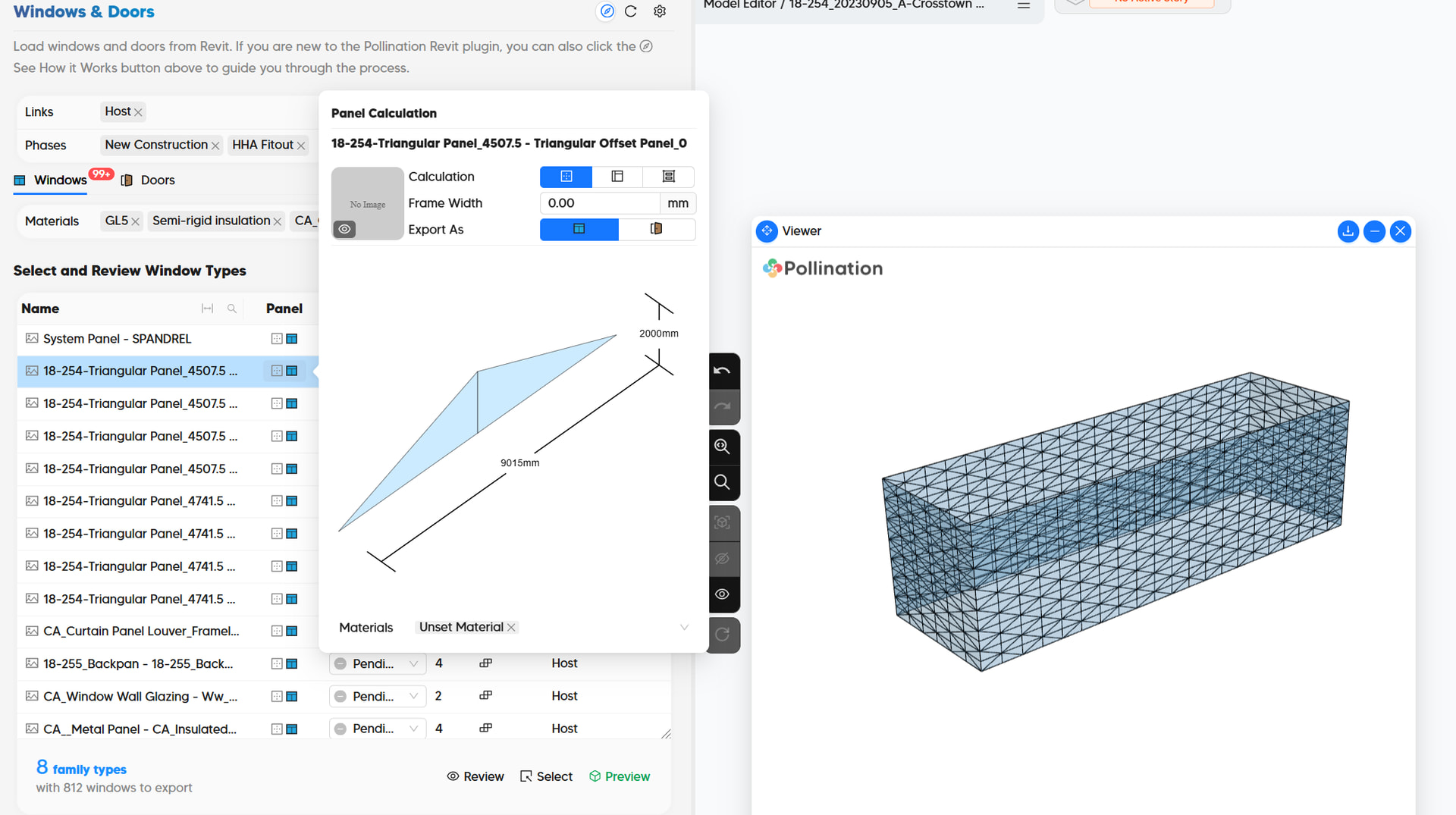

I have an update for you. It took us some time, but we added support for adaptive components. At least it works for this model.
This feature will be included in the next public release.
