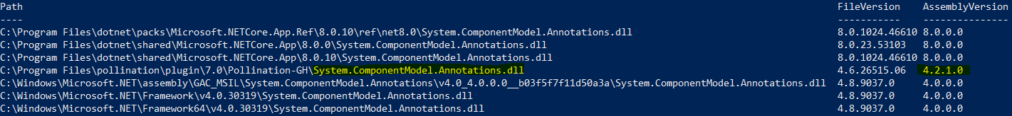

@mostapha Thank you for the quick reply. I verified the Pollination.GH.gha file is in its correct location and is not blocked.
After digging into the error a bit more I believe there’s a bit of a bug here where this “Pollination.GH.gha” file is referencing “System.ComponentModel.Annotations.dll” of assembly version 4.2.0.0 but the .dll file is actually of assembly version 4.2.1.0. This .dll file is in the same folder as the .gha. I tried to get the 4.2.0.0 version of this .dll file from NuGet.org to replace it but it does not seem to be available.
My workaround was to add this code to the Rhino.exe.config in the < runtime > block so requests for anything of version 4.2.0.0 are redirected to 4.2.1.0:
    <assemblyBinding xmlns="urn:schemas-microsoft-com:asm.v1">
      <dependentAssembly>
        <assemblyIdentity name="System.ComponentModel.Annotations"
                          publicKeyToken="b03f5f7f11d50a3a"
                          culture="neutral" />
        <bindingRedirect oldVersion="0.0.0.0-4.2.1.0"
                         newVersion="4.2.1.0" />
      </dependentAssembly>
    </assemblyBinding>
I’m no longer seeing the error and I can see the Pollination tab now. Let me know if you see any problems with this workaround. If I run into a different problem because this fix turns out to be insufficient I’ll be sure to post a reply.

Following @Mostapha recommendation I uninstalled pollination and reinstalled the same version but from the rhino plugin download and now it works. It seems there is something off with the other installer.
Here is an update:
