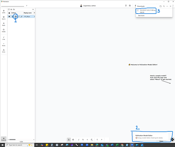

Could someone please advise why am I experiencing this error “Merge_models Failed” within the model editor?
This error message flashes when I try to import the snapshot created into the Model Editor. 1. in the Image below.
The error message is highlighted in 2.

In the Model Editor classic, the import should only be used when you already have a model in the editor. When the editor is empty you should use open instead.
Also, I strongly recommend switching to Model Editor V2. Here is the announcement from last week.
Hi @mostapha,
The suggestion worked and snapshot is now imported.
