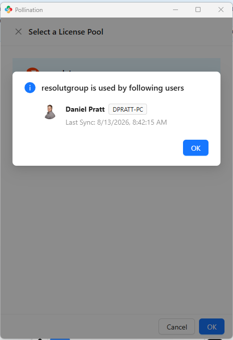

My license is part of a pool for a company, but I’m the only one trying to use pollination at this time.

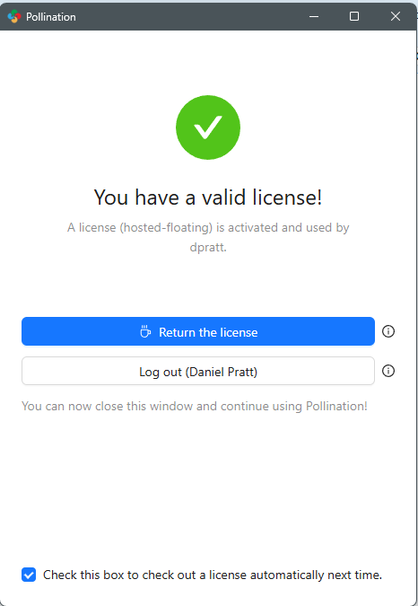

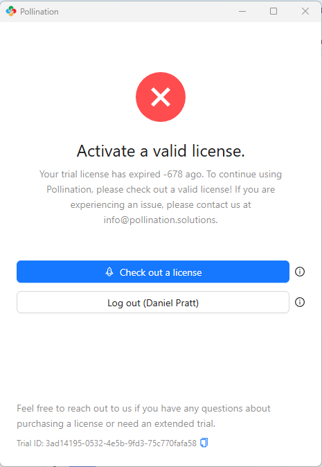

I tried the desktop model editor, but there’s no way for me to get data from Revit that way. There was a license issue, but it seemed to resolve itself after logging out and in again. I was able to save the the default model after loading it from the About menu.
