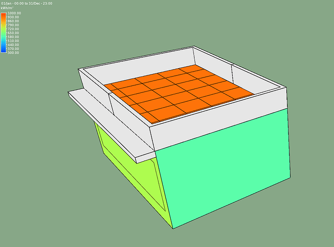

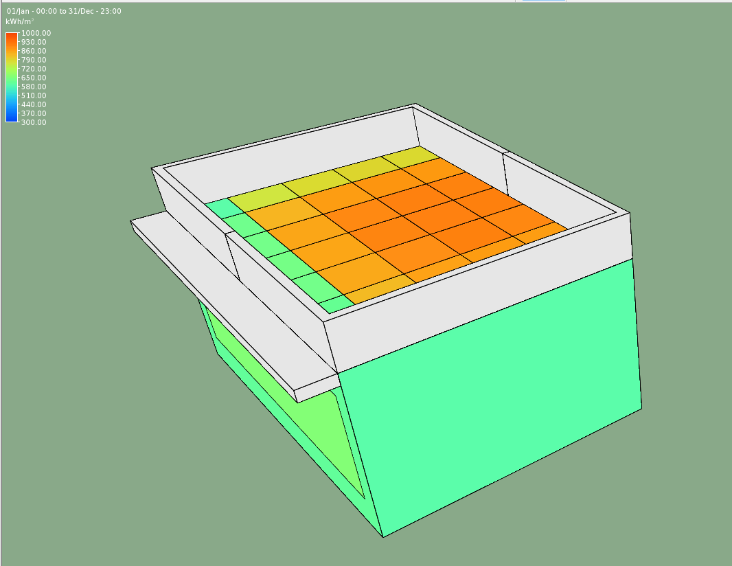

From the user feedback, we realized that IES ignores the single planar faces for suncast if they have zero volumes, and are exported as single faces.
Here are the shades as faces.
And here is the same model when it is modeled as a closed volume.

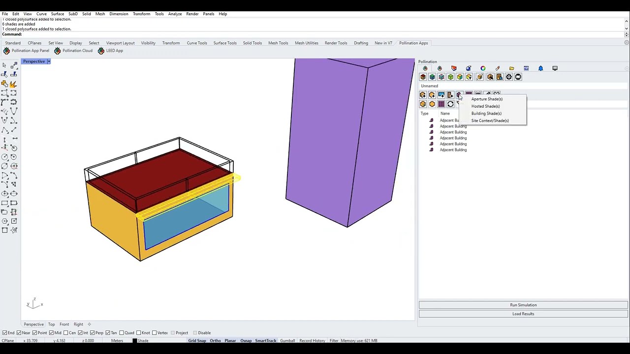

How does the Rhino plugin work
The logic of the Rhino plugin is to group the shades that are created from a closed BREP together as a single volume with no extrusion. If the shades are created from separate faces then it extrudes them to avoid the issue that I mentioned above. Let me know if it is not clear and I can record a longer video. I also recorded this video when we developed the feature that should clarify how the process works.
