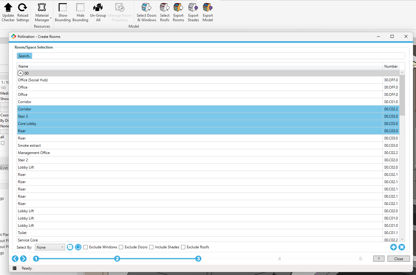

Meanwhile, you should be able to use the Revit plugin to only export the parts of the model that have changed drastically by only selecting the rooms that you’re interested in, instead of exporting all the rooms on the floor.
